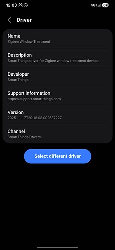

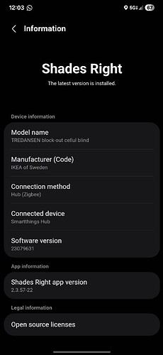

Here are screenshots of my device in question.

This is indeed a bug with older IKEA firmwares that reported the battery not following the standard.
Starting in firmware 24.x it is fixed and the battery reading is correct. They did the same with the buttons.
