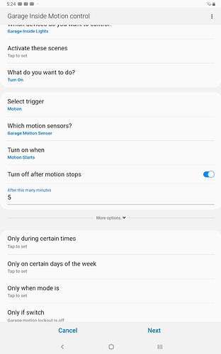

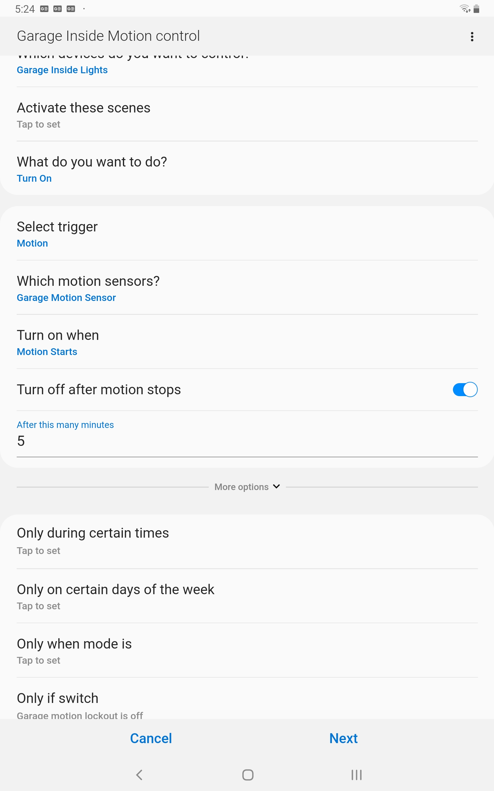

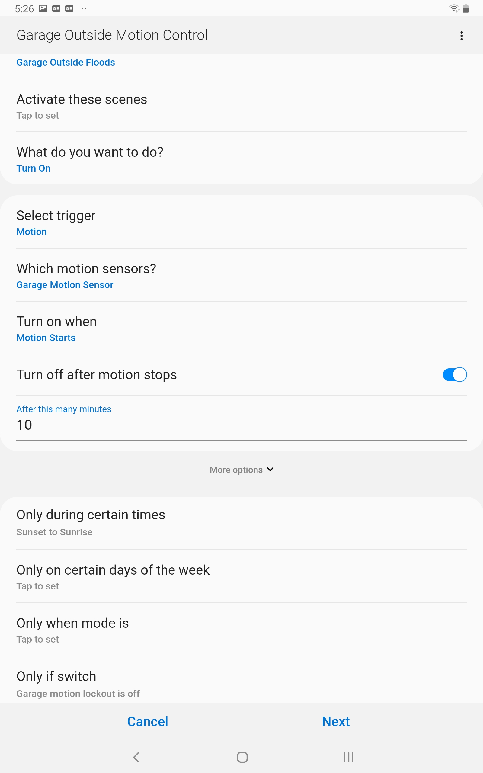

I have something similar for my inside garage lights. I use a SmartThings motion sensor to trigger Leviton switches. Inside lights go out after 5 minutes of no motion.
I had issues with the lights turning off when I was using the weight bench. I added a virtual switch that I call “garage motion lockout”. The whole “turn on with motion” automation is conditioned to not run if the lockout is switched on.
So I can switch on the lockout, manually switch on the lights, and they stay on until I want them off.
I’ve got a second one that turns on outside floods on the same motion detector with the same lockout but only between sunset and sunrise
