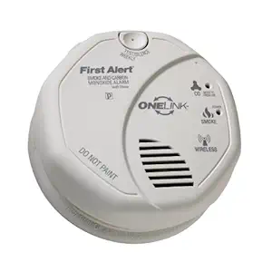

There’s another model of the same First Alert that natively ties them all together, along with a voice alert description of which unit detected smoke. Unfortunately, that model doesn’t seem to have Z-Wave.
Wireless “One-Link” interconnected, but not Z-Wave or smart home compatible…
http://www.amazon.com/gp/product/B000EVO7C2/ref=pd_lpo_sbs_dp_ss_2?pf_rd_p=1944687522&pf_rd_s=lpo-top-stripe-1&pf_rd_t=201&pf_rd_i=B000FBQC1K&pf_rd_m=ATVPDKIKX0DER&pf_rd_r=0ZVBKXHY3CFP4NZ7MCET
I bet the Z-Wave I originally linked to is reduced price as a way to clear stock for an upcoming model.
