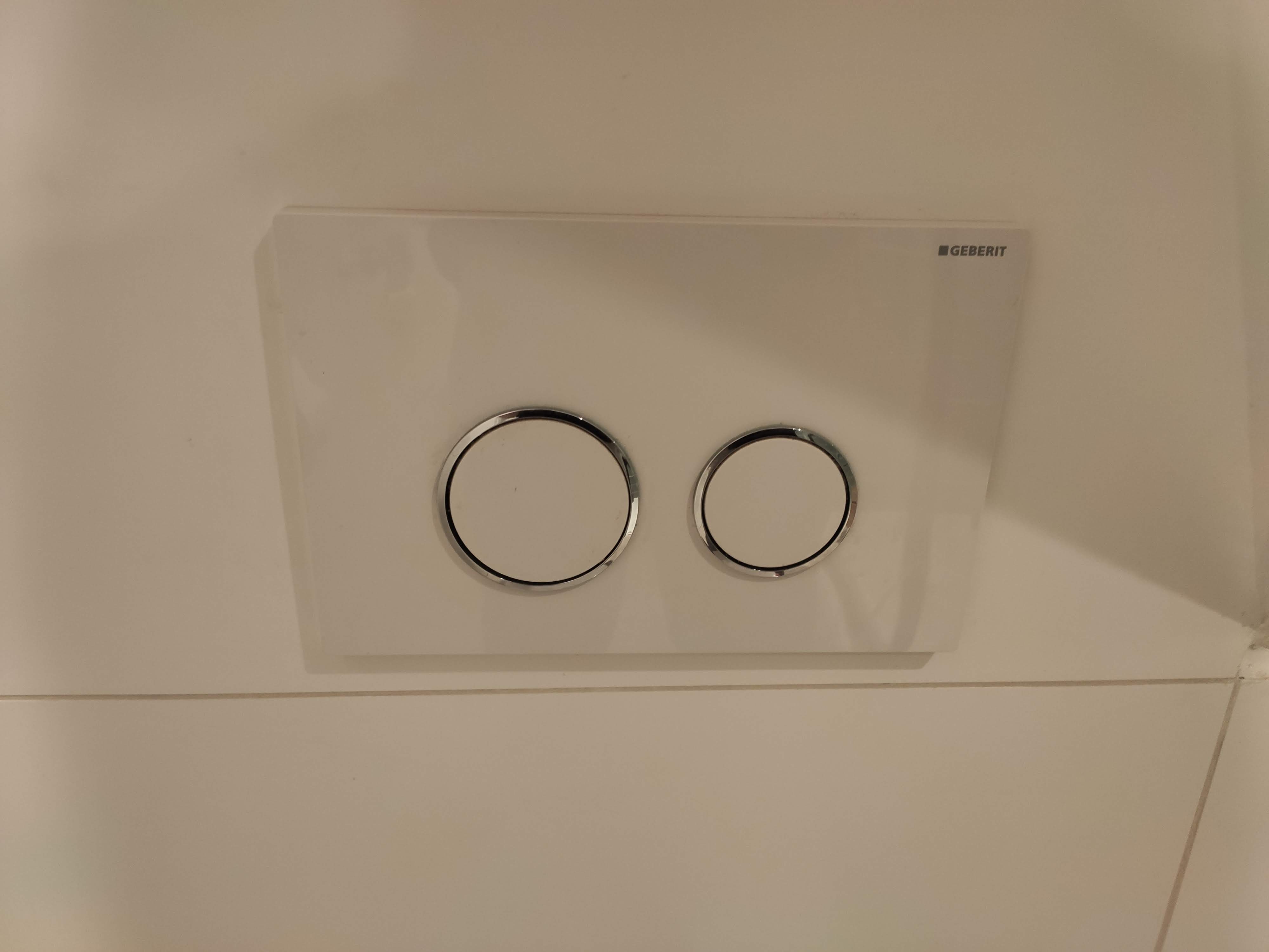

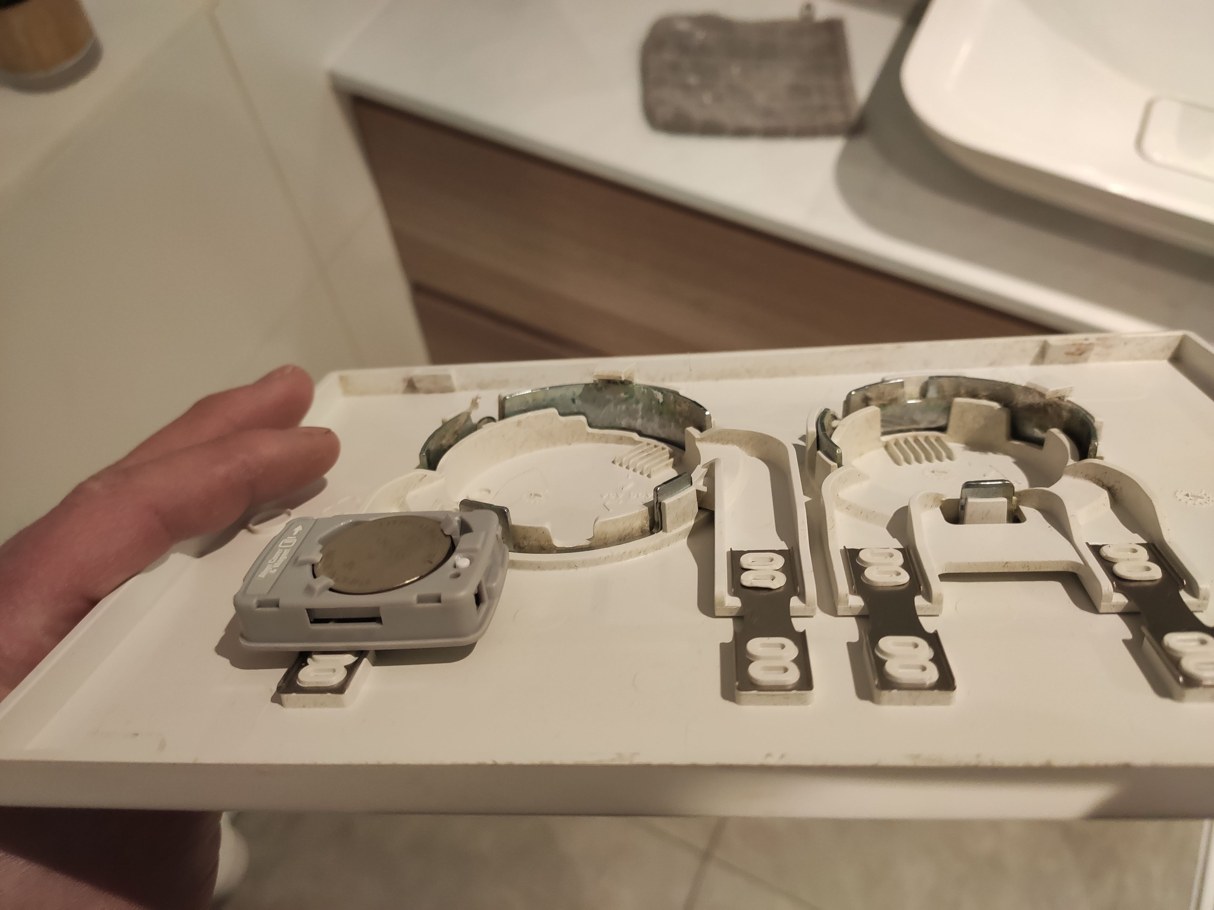

So I thought I had this brilliant idea of mounting a multipurpose sensor behind the no.2 flush so when you push it it turns on the ventilation in the bathroom.
Works, but… because of the sensor being so sensitive it also turns on when I push the small button. Figured i could fix this using the axis variables with sharptools.io. But because there are so many variables depending on how hard one pushes the button this doesn’t fix my problem. Does anyone have a suggestion for the solution to this? Thanks!
Distinguishing between the two buttons is going to be challenging, it may be that the entire face plate vibrates a little when you press either button. As @Alwas said, it may just take some trial and error.

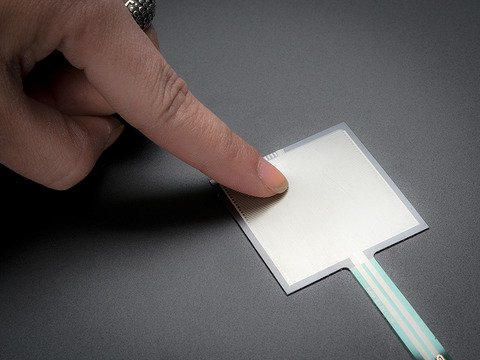

The only thing that occurs to me initially would be to use a very thin pressure sensor, typically film with an embedded wire, and then use that with a sensor with dry contacts that will fit so that the sensor can send the notification. I’m sure you could put it on top of the button, but that would ruin aesthetics, and I don’t know mechanically if you can put it behind the button without affecting the operation. But there is a large variety of these available at relatively low prices for robotics hobbyists.
The pressure sensor itself doesn’t have any way of communicating to smartthings, so you have to connect it to another device that does. But people have done it, it’s the same principle as putting a pressure mat under a sofa cushion or mattress or welcome mat.

Persevere was an understatement but I managed to get it to work in the end. Real precision work but works perfect now, thanks! Would have given up without your comment.
