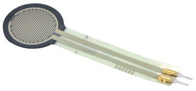

I am building an Outdoor rinse shower near my pool. I have a need for a waterproof switch activated by some one standing on a wooden grate. I found “Pressure/Force Sensitive Resistors (PSR)/(FSR)” and bought a couple from Sparkfun:
I thought it would be amazing if I could just wire that into the internal 2 pin connector of an Ecolink Door Sensor. I think everyone knows that besides the magnet operating the sensor, there’s a couple of pins to “remote the action.” Any dry contact (meaning- doesn’t supply electricity - uses the Ecolink’s,) will work. What I didn’t know is if this resistor would.
The PSR has near infinite resistance (>1m ohm) when no pressure is applied and then drops to around 10k ohms depending on pressure/force. It’s not accurate enough to use as a scale, but if the Ecolink would respond to low(ish) resistance on it’s two pins, I’d be in business. Details on how a PSR works is here:

I got the package of PSRs today and wired one up to a spare Ecolink Door Sensor (DWZWAVE2-ECO) and pushed on the PSR. The light blinked!! And then when I removed my finger, it blinked again. I could also see on the status pane for the door sensor it would go from open to closed. I tested it a lot of ways and found it would work exactly as I’d envisioned.

Basically, it works. It closes the circuit with a very low amount of pressure. Tapping your finger on it like you were tapping on a table waiting will set it off.
