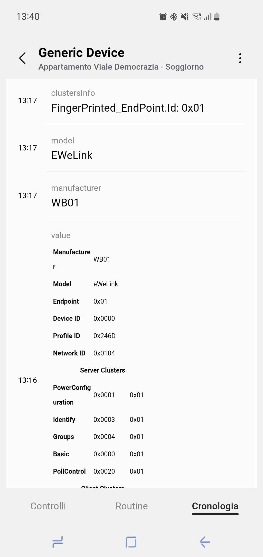

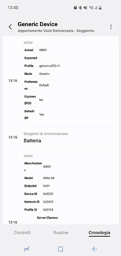

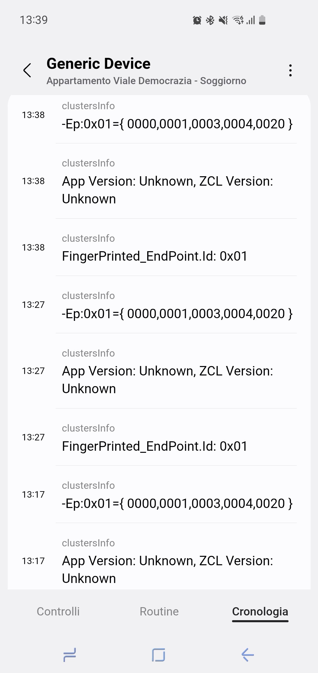

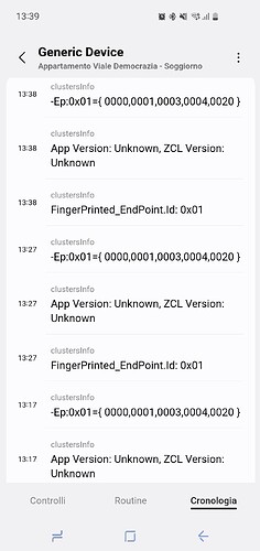

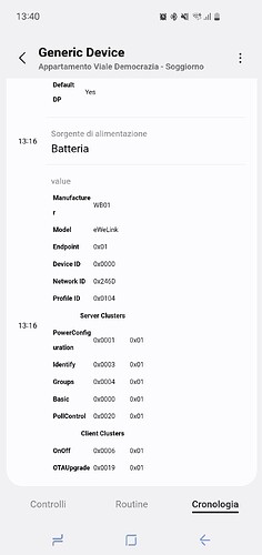

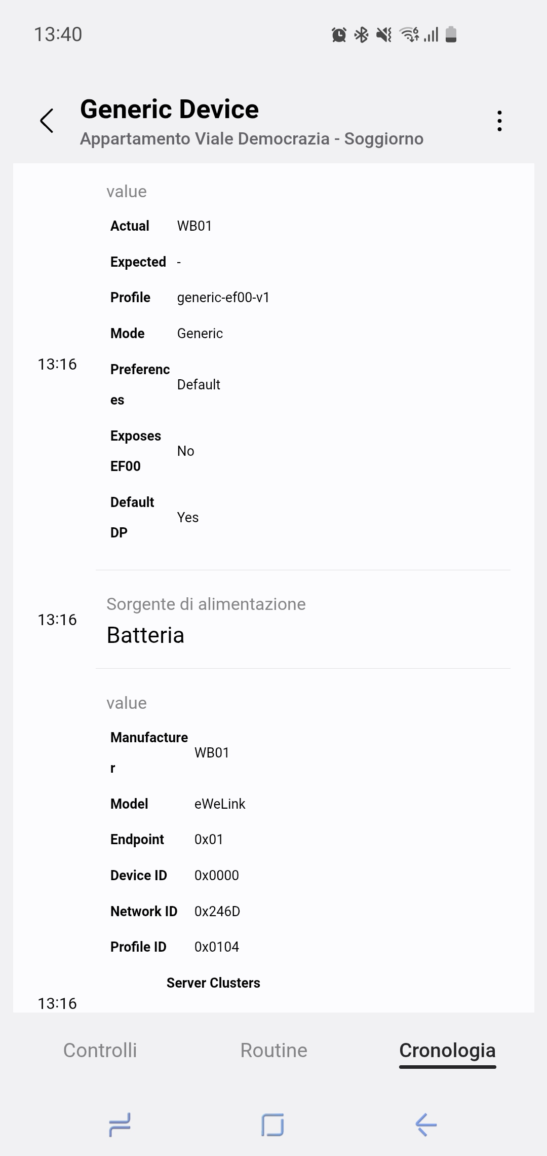

hello everyone i tried to add this device but it doesn’t see driver. i also tried @obmaz driver but it doesn’t see it can someone help me?
According to your screen shot this is not a Tuya product but is an eWeLink product. They are competing companies.

All my Sonoff buttons are early models which identify in manufacturer model terms as the eWeLink WB01 rather than using their own branding and they are supported by the stock Zigbee Switch driver.
Your screenshots are curious in that the manufacturer and model are being displayed the wrong way round. Either that’s a bug in the driver you used or you have a particularly odd device that identifies as a WB01 eWeLink.
