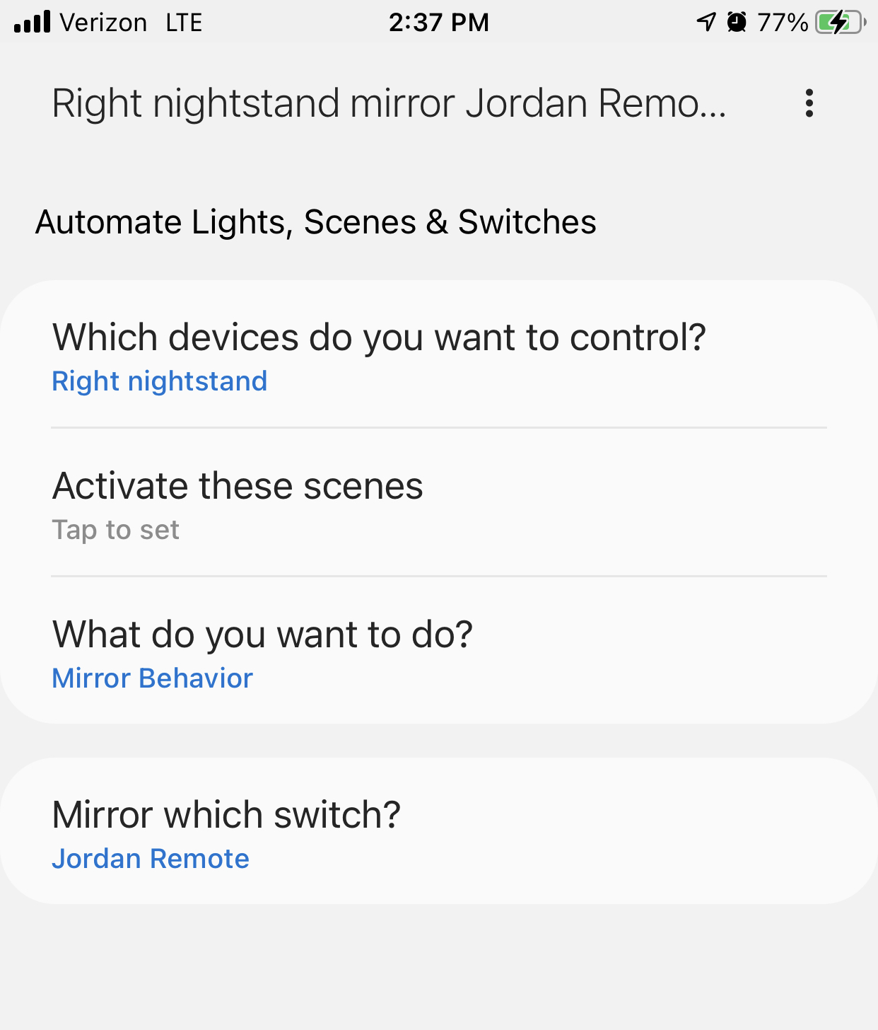

I know this is an old conversation, but it’s one of the first search results for people looking to see how they set up the dimmer switch with SmartThings. Since I just set one up, I figured I would mention a small difference that is not as evident.
Open the SmartThings app and press the “+” sign on the main page.
Then, press “Routine” (note that this used to be add Automation")
At the bottom of the screen, switch over to “Discover” and scroll down to the Smart Apps section and choose “Smart Lighting” (the step of switching to “Discover” is new and not evident when reading the old instructions which still appear on the Sengled site and in previous posts of this conversation. The test of the steps are the same)
Select “New Lighting Automation”
Under “Which devices do you want to control”, select the bulb(s) you want to control using the Sengled Smart Switch; then, press “Done”
Under “What do you want to do”, select “Mirror Behavior”, then “Done”
Under “Mirror which switch”, choose “Sengled Smart Switch” or whatever name you created for the Sengled Smart Switch. Then, tap “Done”
Press “Next”, you can create a custom name for this control, then press “Done”.
Now you can use your On, Off, Dim-Up, Dim-Down buttons to control your smart LED light(s).
