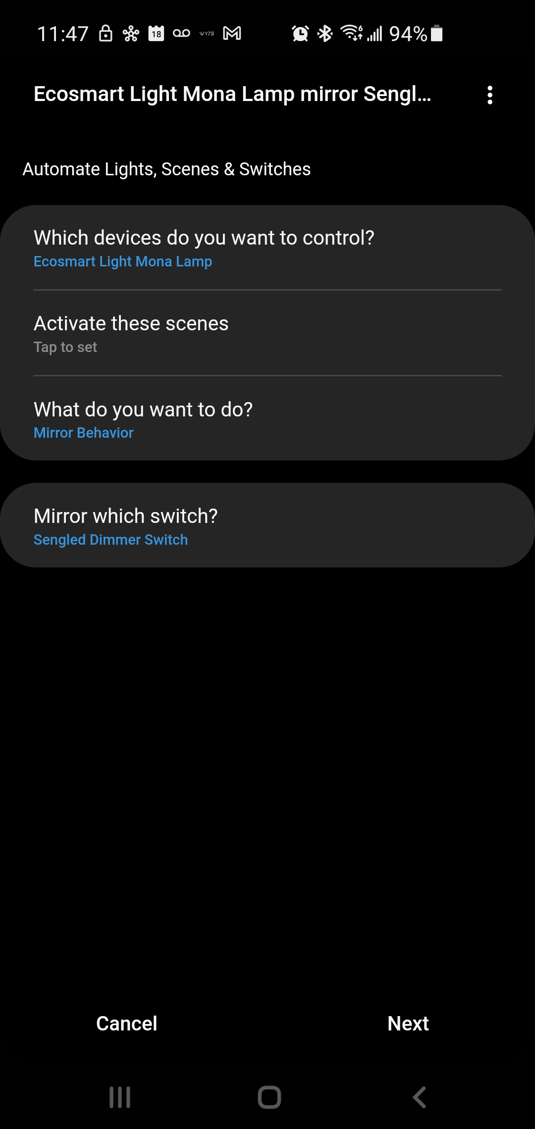

Is there a way to make this work in the latest SmartThings app? My understanding is that the Classic app has been deprecated and can no longer be used.
When I create a Routine and select my Sengled dimmer this is what I see.
Use Smart Lightning app.
