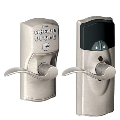

The FE599 and BE469 (top line) are very different locks with different purposes. I have all the Schlage models but these are my favorites.
The 469 is more of a motorized deadbolt where as the 599 is more of a door level with no motorized parts (it has a pin lock internal that’s motorized). the 469 has an alarm which I find useful to know if someone’s tampering or using the door or entering wrong codes. However with a motorized deadbolt is VERY sensitive to door alignment, if the door is slightly mis aligned (say closed hard and bounces back a bit or not closed enough) the deadlock won’t engage. The 599 is more resilient that way since it the lever engages as soon as you shut it (no bounce back issues) and the internal pin disengages the lever to prevent the lever from turning when you remotely lock it.
The 599 however only supports 4 digit pins and the 469 goes upto 8 (if that matters to you). Really you need to think about the usage. I find the 599 perfect for a deck/garage door and the 469 for the main door. Having said that I’m also using the 599 for another entrance door which isn’t used frequently.
Battery wise key thing to note while the 469 surprisingly uses less battery than the 599 (and I use the 469 more than the 599 in a daily basis) however it dies when the battery hits 50% where as the 599 goes on below 30% (it’s been a year now and my 599 is still as 35% where as I had to change my 469 batteries when it hit 50%). That because the motorized deadbolt uses more power and causes a higher voltage drop so at 50% the voltage drop is to low for the lock (using alkaline duracell) and it shuts down. Make sure you replace the batter no later than 50% of the 469 otherwise you may be like me and up trying to remotely lock it and it won’t work.

Looks good but the schlage century in nickel is more to my tastes , I assume the difference is only skin deep?
I have the schlage lever key pad one Chris @cldlhd , and so far it is working good :smile:
