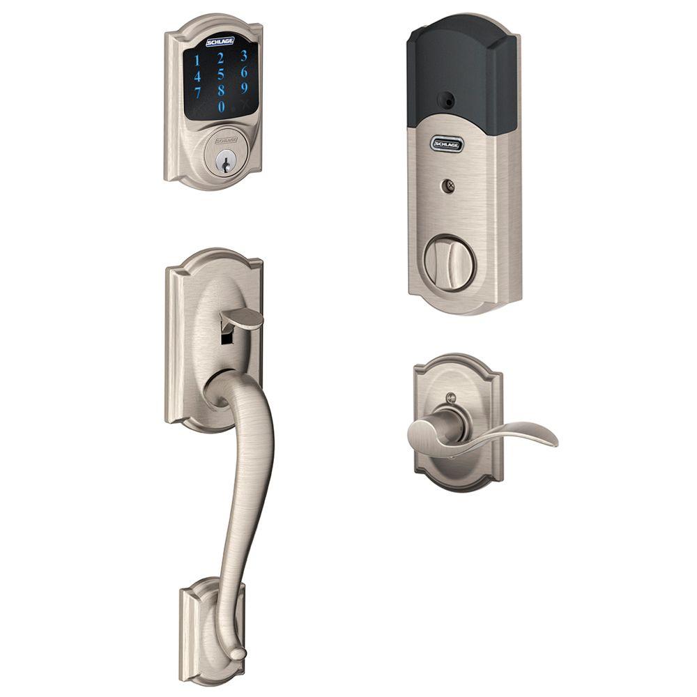

Sorry so dense, but is this a two-door set, or just for one door?
I’m not sure what all of the different pieces are for, and it looks like there are pieces enough for two doors, but I’m sure I’m looking at it wrong lol
EDIT: Actually, I get it now. It’s for one door; both sides get a deadbolt piece and a door handle piece. :slight_smile:
