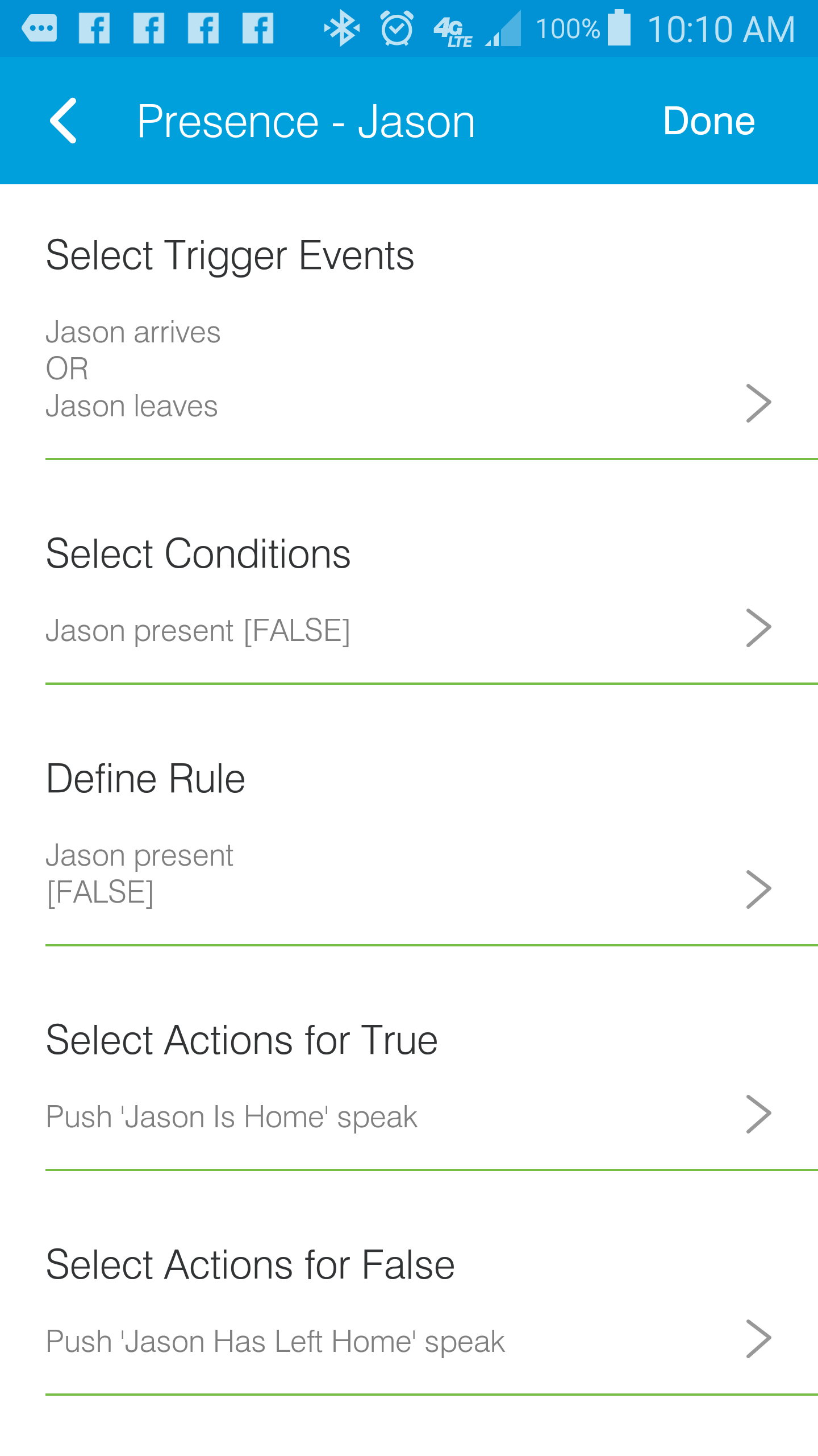

I removed all of my family devices as presence sensors and I deleted all rules in shm. Mine is blank. I integrated life360 into ST she had each family member create a life360 account. I then use rule machine to set up the presence sensor monitoring rules for each family member like this…
Each family member has a separate rule in RM. Each rule sends a push message, some also include text messages, and all have announce arrival over the speaker system.

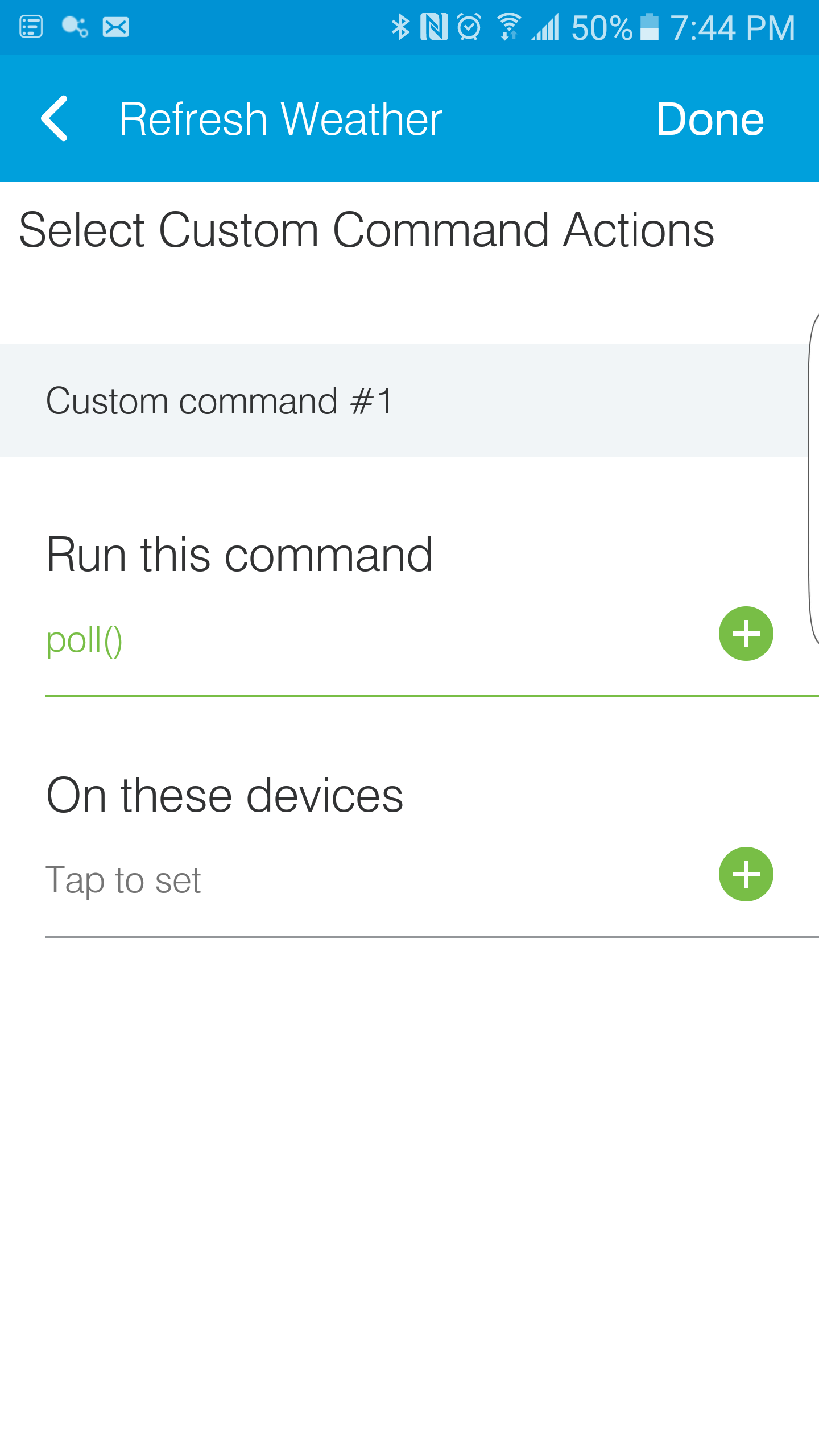

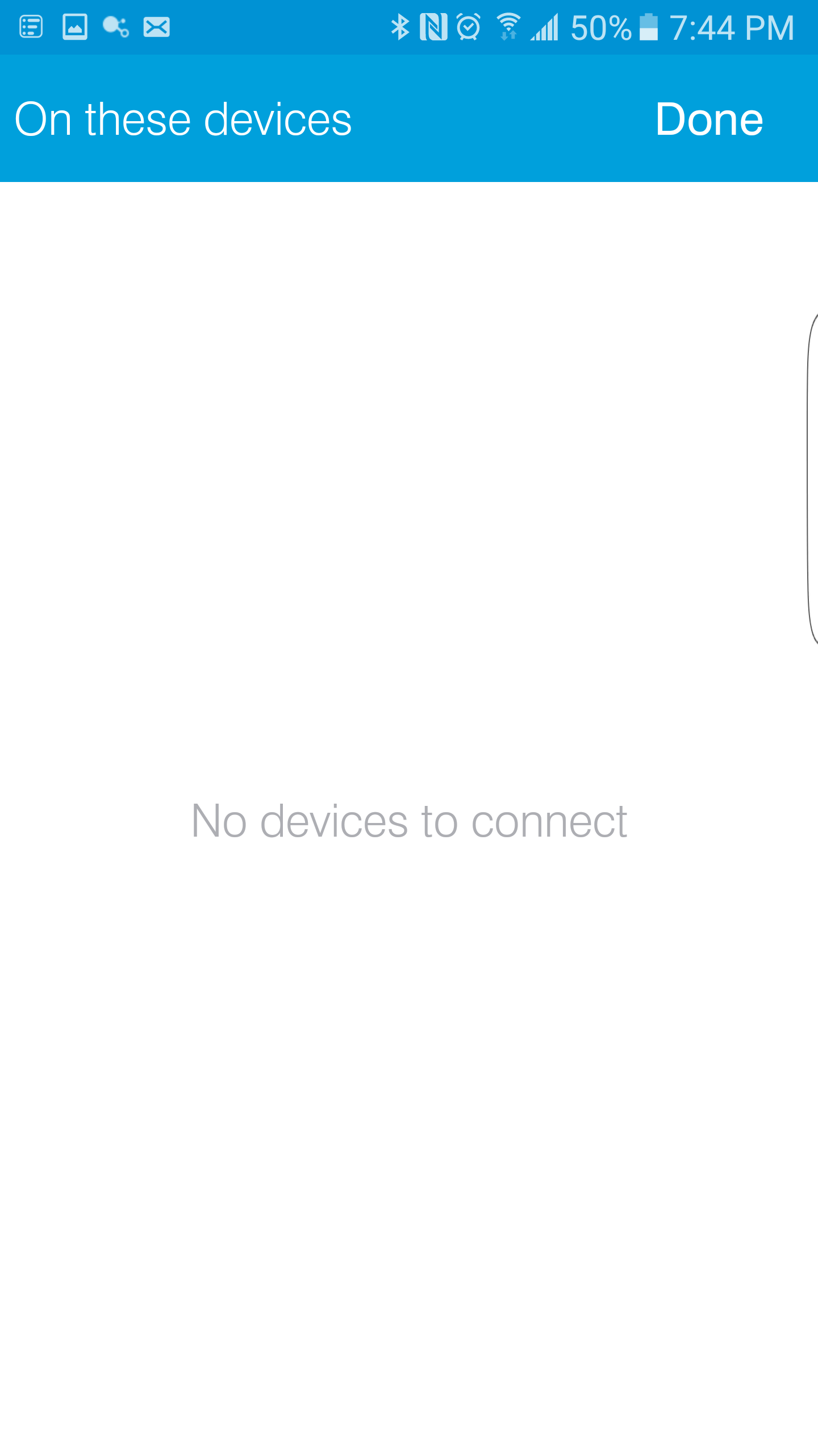

I created a custom command poll(Weather) in order to refresh my SmartWeather Tiles 2.0 device. I named the device Weather. When I did “Test saved command on Weather” in RM it worked. However, when I created a Trigger with 15 minute intervals. I selected the action to run custom command and choose poll(Weather). However when I selected “On These Devices” I get nothing. I tried the same thing creating the command poll() and still I have not device to select in the rule.
When you are using a custom command, tap on select actions and scroll to the bottom of the screen. You will see Run Custom Commands.
Weather will show up in that section under On These Devices.
Yep, that’s what I got, but I get No Devices Connected.
