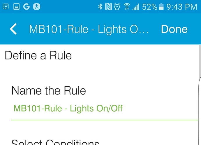

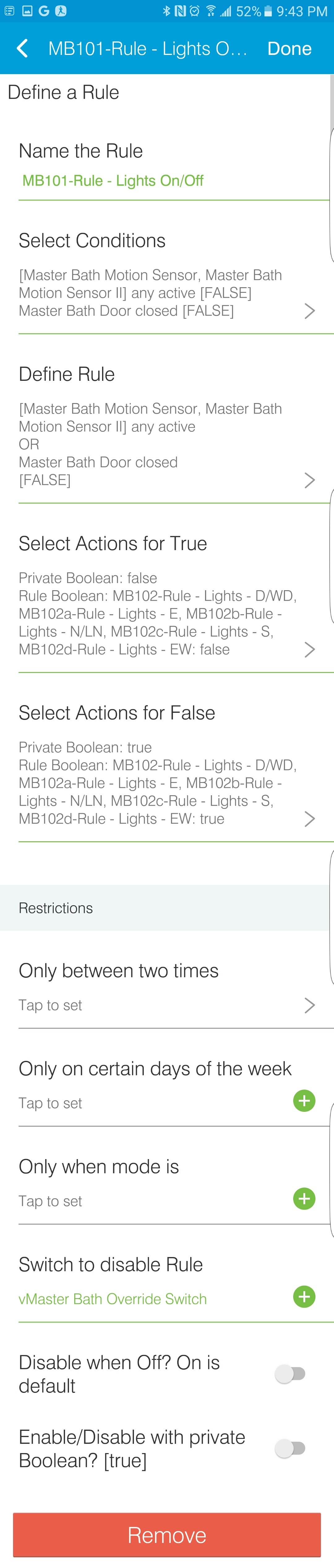

So I think I’m stuck and/or my logic is incorrect. What I think I’m trying to do is have a virtual switch come on which when on will disable my automation starting with my rule MB101-Rule - Lights On/Off (hub) and those that follow (spoke). I created a virtual switch called vMaster Bath Override Switch and I tried 2 options (a rule and a trigger) and neither has worked when I physically turn on the switch (trigger) or use a rule to set the hub rule to false.
MB200-Rule - Override Switch
Conditions: vMaster Bath Override Switch on
Rule: vMaster Bath Override Switch on
True: Private Boolean:MB101-Rule - Lights On/Off: false
False: Private Boolean:MB101-Rule - Lights On/Off: true
MB200-CTrigger - Override Switch
Trigger: Master Bath Light physical on
Condition: Master Bath Light on
Rule: Master Bath Light on
True: On: vMaster Bath Override Switch
Fasle: Off:vMaster Bath Override Switch
@twodaend
When you tried the private Boolean… Switch on = set rule to false.
You have to make the private Boolean a part of the rule.
In your hub rule add this:
Conditions - add "private Boolean true"
Rule - add “AND private Boolean true”
Now, set up your override rule like this:
Condition - switch on
Rule - switch on
Actions for true - set private Boolean: hub rule: false
Actions for false - set private Boolean: hub rule: true
It should work then.
