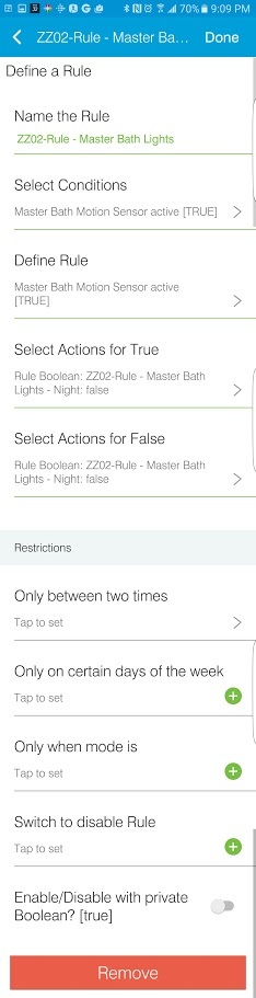

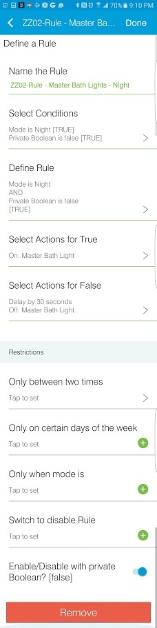

Thanks for the spreadsheet. This looks great. I’m trying to follow the logic and used the bathroom as an example. I tried creating my own, but something is not right.
@twodaend
Master Bath Lights:
  • the Actions for True and Actions for False are exactly the same. Change the Actions for False to making the Master Bath Lights - Night rule True.
Master Bath Lights - Night:
  • Actions for False - Remove the Delay by 30 seconds and choose
    Pending Off: Bathroom Light: 30 seconds:Cancellable
Note - Turn off the enable/disable with private boolean option until you get the rules working. I’m not sure this will work when using the private boolen as the on/off for the rule. I’ve actually never done it that way as I choose to use a virtual switch or physical switch for my disable.

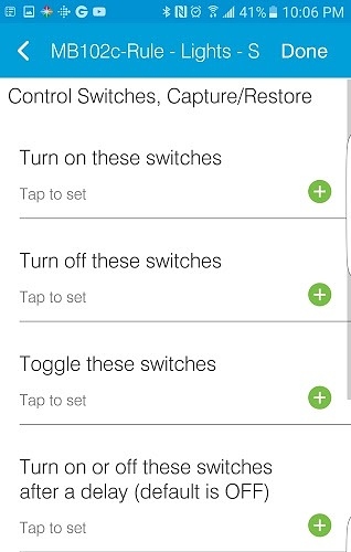

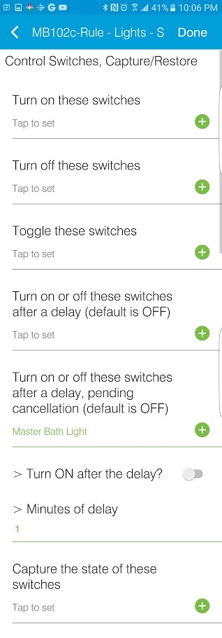

I got all of my modes setup, but I’m stuck on the sleep mode. I want the lights to go off after 30 seconds of no motion, but I only see minutes as an option. Is it possible to do a pending off of less than a minute? When setting the delay action you can do minutes.seconds and milliseconds, but for pending off cancellation, I only see minutes.
What veer of rule machine do you have?
Mine is 1.9.1f and fur pending off I have minutes, second, and milliseconds.
I’m using 1.9.0a/1.9.1f. The none cancelable option above I do see second and milliseconds but when using the cancelable option I only get second.
Pending Off/On with Cancellation is only available in the Rule option. It is also only available with minutes pending. If I remember what Bruce said, the pending timer is different than the Delay timer.
So, it’s not an option. Only a minute.
