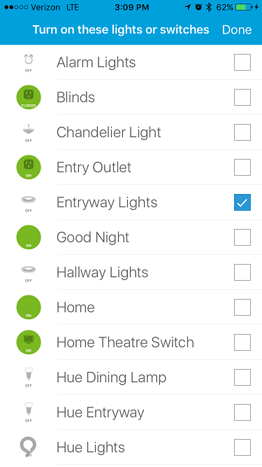

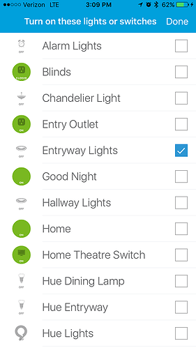

Here is an example of a routine ā€˜I’m Back’ with issues. Normally triggered with iphone presence but I just triggered manually with same result/issues. Routine is as basic as they get, simply turns off SHM and also turns on one light switch. But for last month it has turned on additional lights that are not part of the routine
