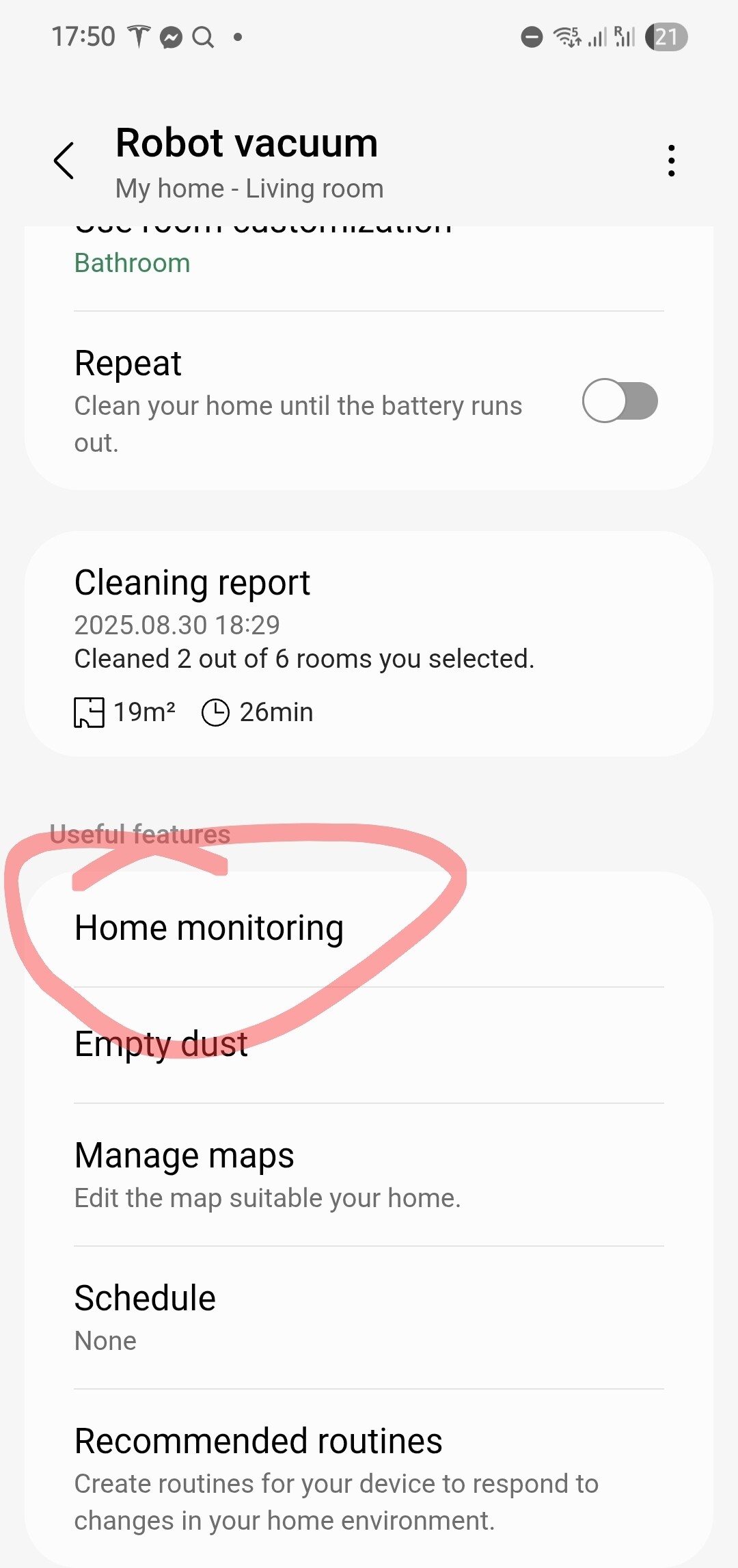

This is how it looks for the previous model:
Scroll down in the main device menu
Schedule monitoring time

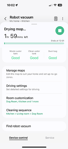

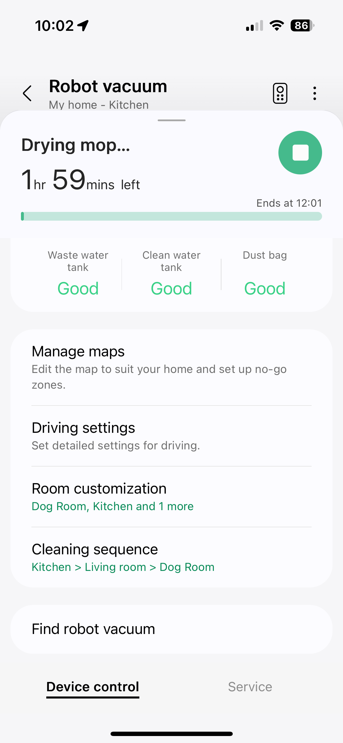

Thanks but I don’t have that on mine :sad_but_relieved_face:
