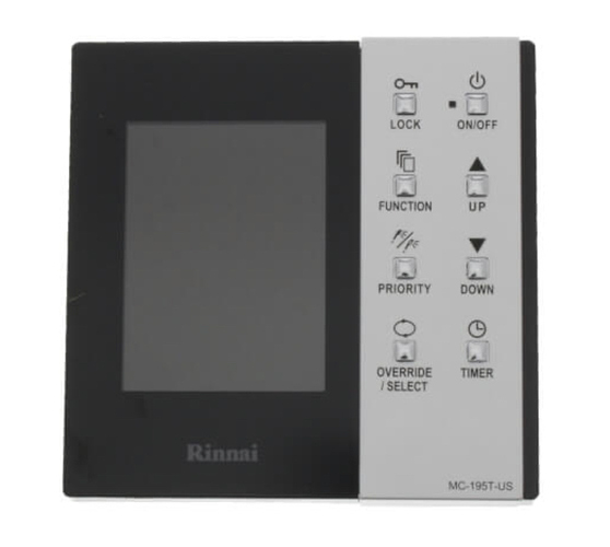

This is what I did. I don’t have the Control R module but instead have a display mounted on wall in master bathroom. It has a recirc button you can press to turn on. I soldered a 2 conductor wire to both side of the button and connected that to a dry contact relay that basically virtually presses the button. It’s been working great.
I’ve been lurking on this thread since the announcement and was interested in this integration but when I called Rannai you can either use the Control R OR the display and not both for some strange reason.
Agree with this solution. I have the wi-fi module and use the Control-R app to set the programming of when recirc happens on its own. I have also installed the Rinnai Alexa skill and can tell her to start re-circulation if its outside of the programmed times. “Alexa tell Rinnai I need hot water”.
Yeah, it says the same thing in the manual.
“DO NOT install the MC-195T-US Timer/Controller and Control-R™ Wi-Fi Module together as they are not
compatible accessories.”
