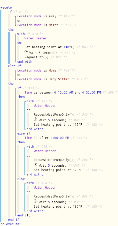

This may be a silly question, but I implemented your Rheem Hybrid code and have another request. I just recently installed an 11kW Solar Panel System on the house. I only want the Water Heater to come on between 9am and 7pm. How can I set something up to turn it off at 7pm and turn it back to Heat Pump only at 9am.
Trying to only have my water heater work when solar is producing. Thanks Again!
I use webcore to turn my water heater off after 9 PM. And back on in the morning.
I am a newb and have manged to install Webcore…can you send me some sample code for the piston? I appreciate ya!
Thank you so much Brian! I really appreciate you. That is a really advanced script! I love it.
