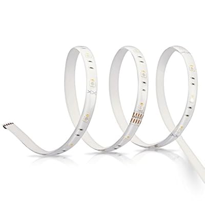

Thank you so much !!! would you share the same opinion on their strip light, as i was looking for a strip light
You have a US hub and 220 V mains, am I remembering correctly? (This is a common set up in South America and some parts of Asia.)
I don’t know anything about the LIFX LED strip product, I would just check the reviews.
Osram Lightify also makes RGB LED strips for 220 V Which can work directly with SmartThings and do not need their Gateway. So that might be less expensive if you can find them.
