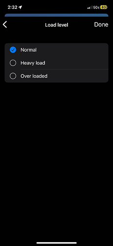

    • Current/load overload cutoff level
    • Current/load warning level
    • Switch state after power failure

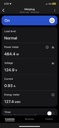

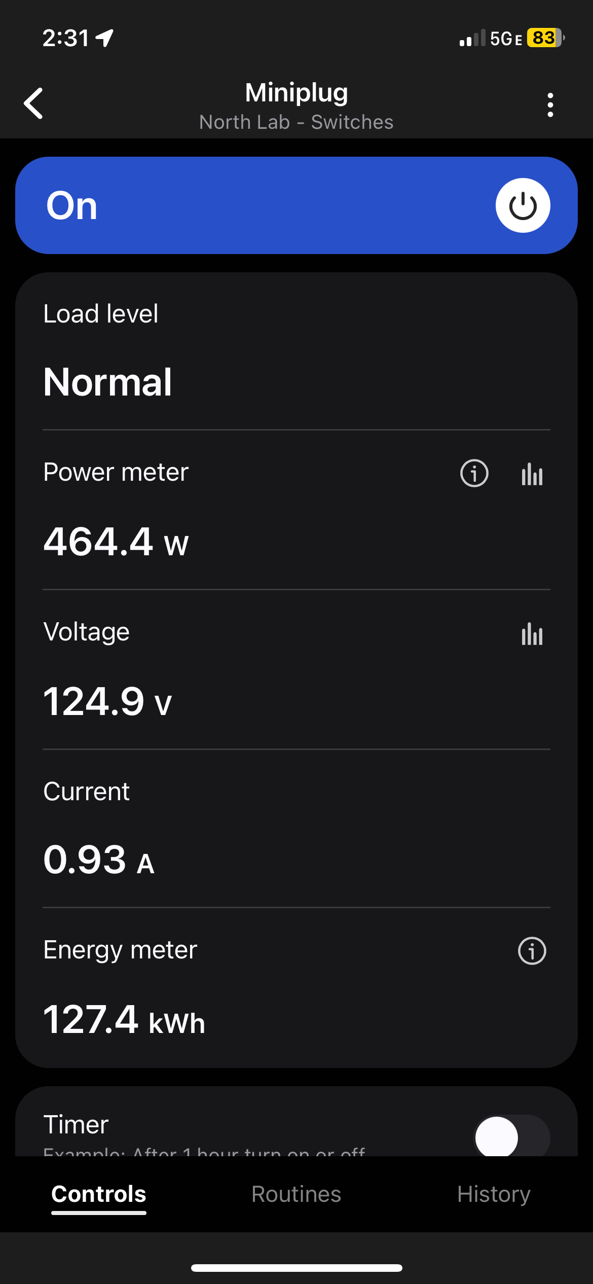

Enhanced Features Include:
  • Interactive user interface (see screenshots below)
  • Overload protection cutoff notification
  • Heavyload warning notification
  • Set LED state through the UI
  • Child protection through the UI (enable/disable manual physical button on switch)
  • Fixes for errors in documentation and firmware quirks
  • Support for routines and automations

  • Current/load overload cutoff/warning level

Enhanced ZooZ AND MiniPlug with Energy Monitoring - Version 20251121
  • Edge driver for new ST hubs
  • Added support for ZooZ Zen15
