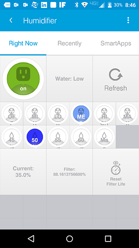

The device handler provides a full-featured manual interface (pictured above). To automate the device, I highly recommend Rule Machine by @bravenel. This device handler exposes several commands to Rule Machine’s “expert features” functionality (thanks, @Mike_Maxwell!) The useful exposed commands are:

Is it possible to rely on an external humidity reading — that is, can one just set the fan speed and have it ignore it’s humidistat, or must one set it?
Yeah. Like I noted in the TODO section, the UI will get an overhaul as soon as the new multiAttributeTile code is released. It’s the “right” way to do a UI for something like this but it’s in a serious state of broken at the moment.
For now, just know that both the fan speeds and the humidities go from lowest on the left to highest on the right.
