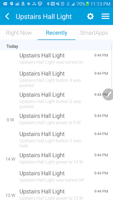

I finally had a chance to hook a toggle switch up to my dimmer 2. As you pointed out, your logs are showing that the dimmer is sending the correct reports when S2 is used:
35ddd6bc-c64d-4e15-9bed-eb22f74ffb63 6:57:34 PM: debug buttonEvent() Button:5, Value:pushed
35ddd6bc-c64d-4e15-9bed-eb22f74ffb63 6:57:27 PM: debug buttonEvent() Button:3, Value:pushed
35ddd6bc-c64d-4e15-9bed-eb22f74ffb63 6:57:26 PM: debug buttonEvent() Button:4, Value:pushed
In the method that fires off the button events, there is only the command to log the info (which is what creates the info seen above), and then the code that sends the event. I really don’t see where a problem could arise. My tests worked without any issues.

Do you see any activity in the “Recently” tab? If you don’t see anything there, can you open up the log in the IDE and see if you see anything there?
