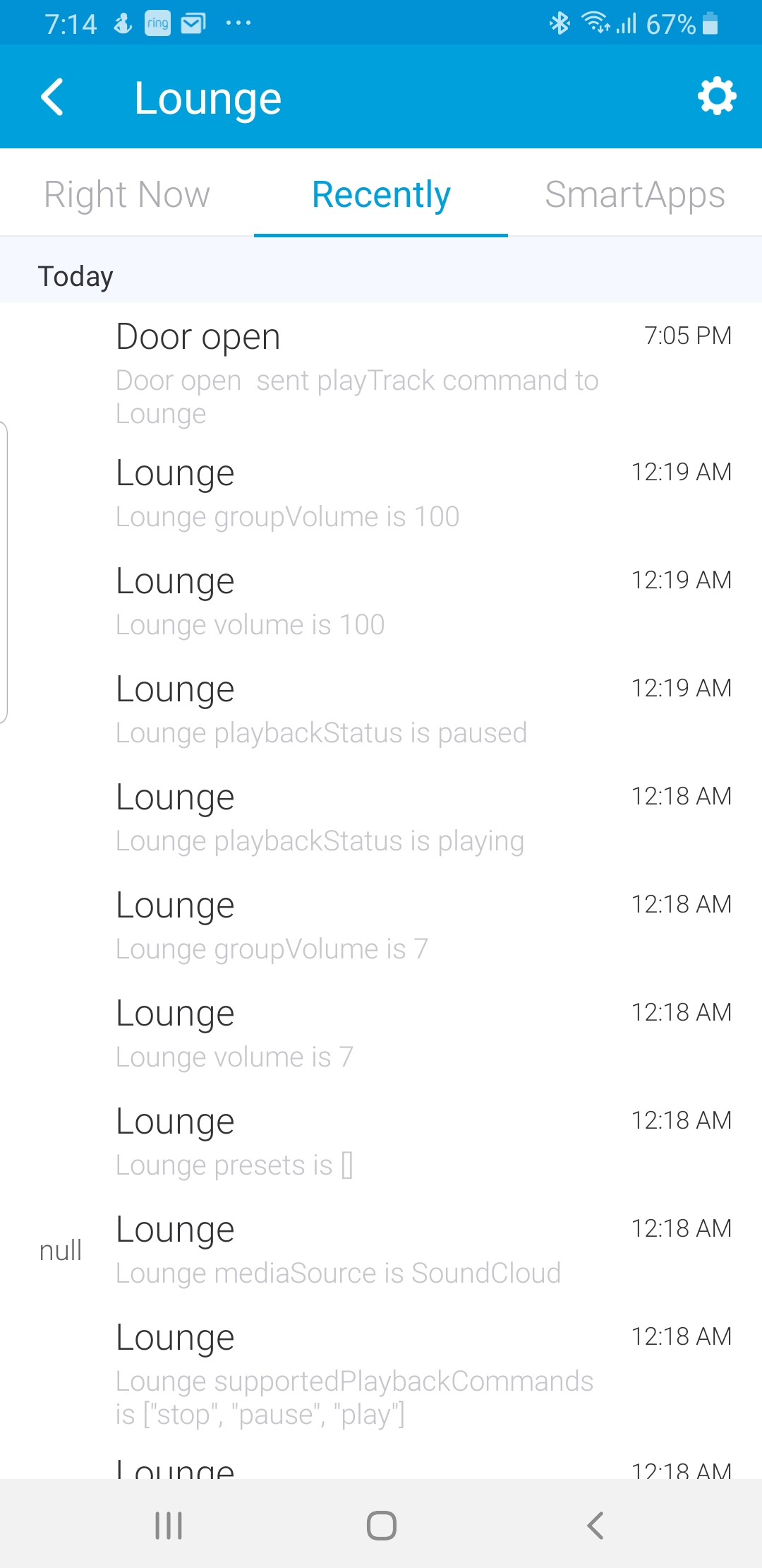

Hi @RBoy with the recent upgrade of sonos integration. I tried using this app. Current setup I have sonos p1 on UK hub I get announcements for door open and close each time regardless of time or day. I tried removing sonos and adding again tried changing device handler no use. This app is the last option I have… i tried using it and it shows it has sent command to sonos but sonos doesn’t speak no TTS I have set it up to say " door open" and " door close" … can you guide me step by step for what am I missing. Many Thanks
sorry for several posts trying to figure out how to upload screenshots. any ways… all i want the app is to state the status of open close sensors when status changes i have 2 doors back and front. previously i was using big talker 2 to run the same task and was working flawlessly. until the recent upgrade in sonos integration. any help will be appreciated in getting this back to work.
