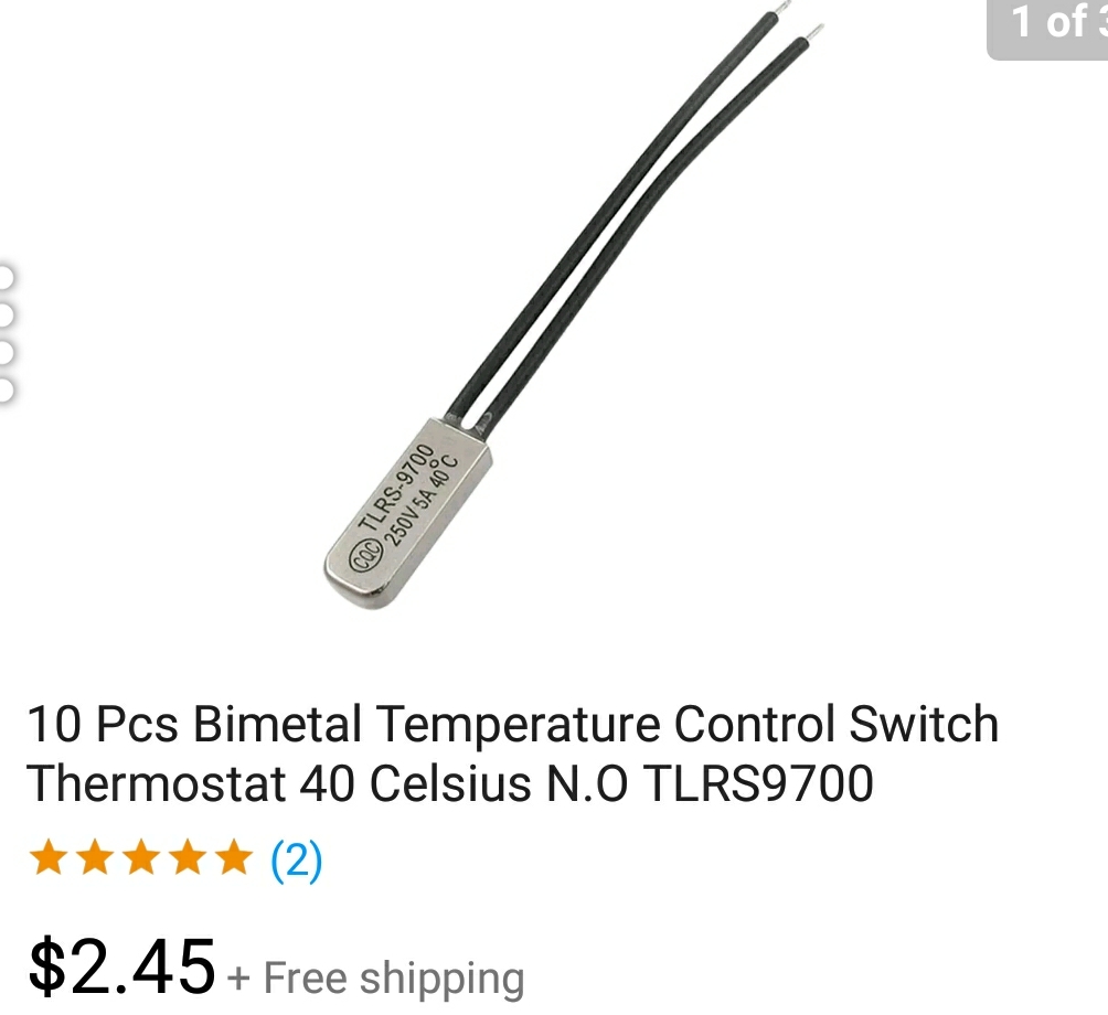

I would like to use these sensors as a thermal alert for a hydroponic radiant heat system. I have 7 zones near each other so I don’t believe that I can use the built-in temperature sensor. I will solder in the attached normally open switches and clamp them onto the heat pipes. Could I trouble @pakmanwg to modify the handler? When the switch reads open the zone would indicate “Off”. When the switch closes the zone would indicate “On”
Hi Bigjjj, are you using it like a smoke detector? Says if it is open, it means clear. And if it is closed, it means detected. If that the case, you can select smoke detector as the function. This will be more natural as smartthings will send you alert if the contact is closed (smoke detected).
If you want it the other way around, I have a new function type “smoke detector closed as clear” in the new version of the DTH v01.04. This will be opposite if the contact is closed, it means clear. And when the contact is opened, it means smoke.
I can create another devices with on and off, but smarthings or actionTiles will not understand what to do with on/off. You probably see a “?” in the tiles.
Let me know.
Best “customer support” on SmartThings here. :slight_smile: Nice stuff, @pakmanwg
@pakmanwg, yes I will be using it like the smoke detector function, open clear , closed detected.
I can use the smoke detector function as you have it already written and remember that clear means off and detected means on. Is there a way to change the icon from a smoke symbol? Actiontiles does not have a selection of icons to choose from on this type as they do on switch types.
Would it make sense to code the sensor as a switch? Then it would have the on/off labeling and icon selection. I don’t know if that is possible or a good idea or recommended by you. Thoughts?
