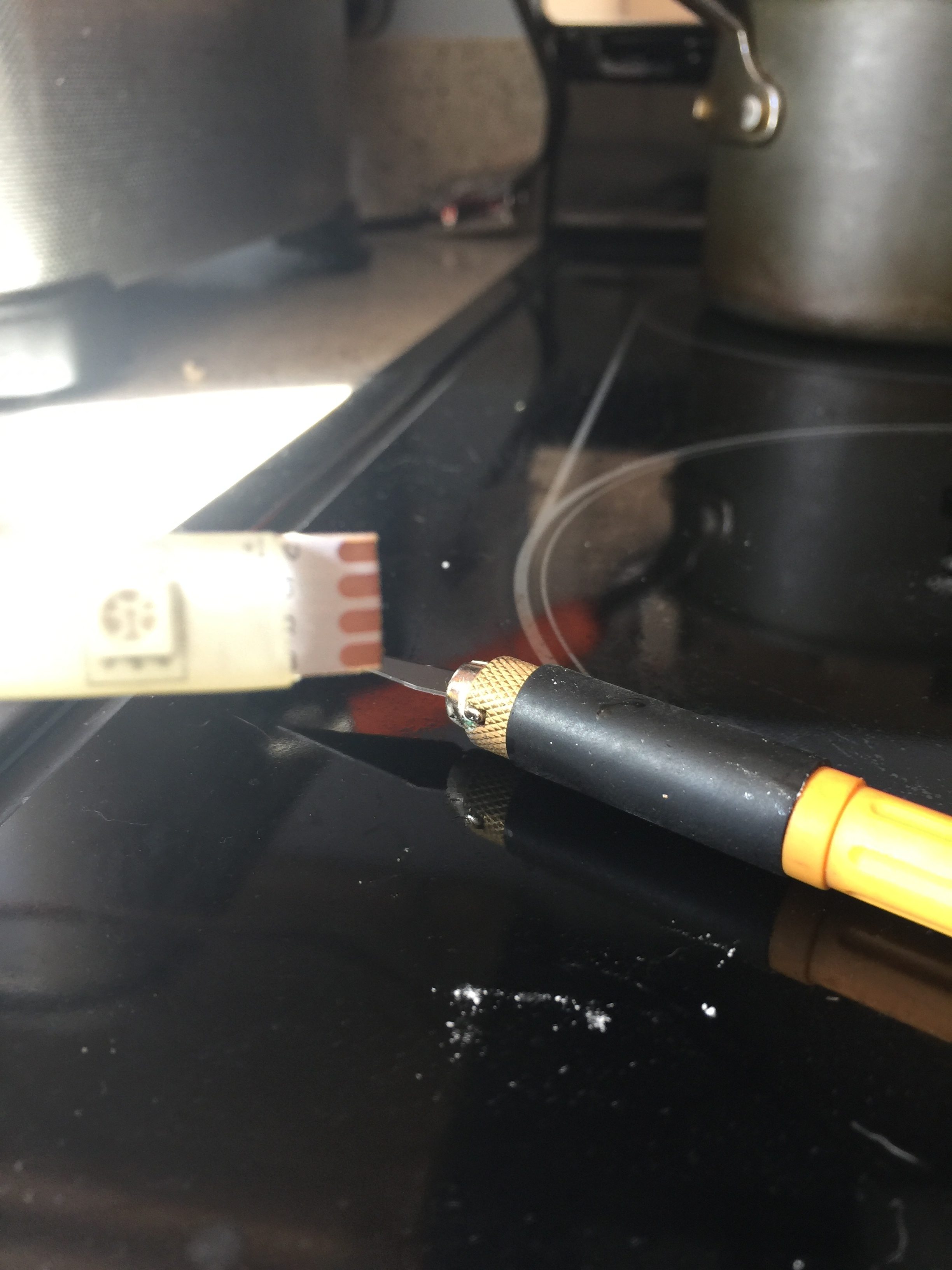

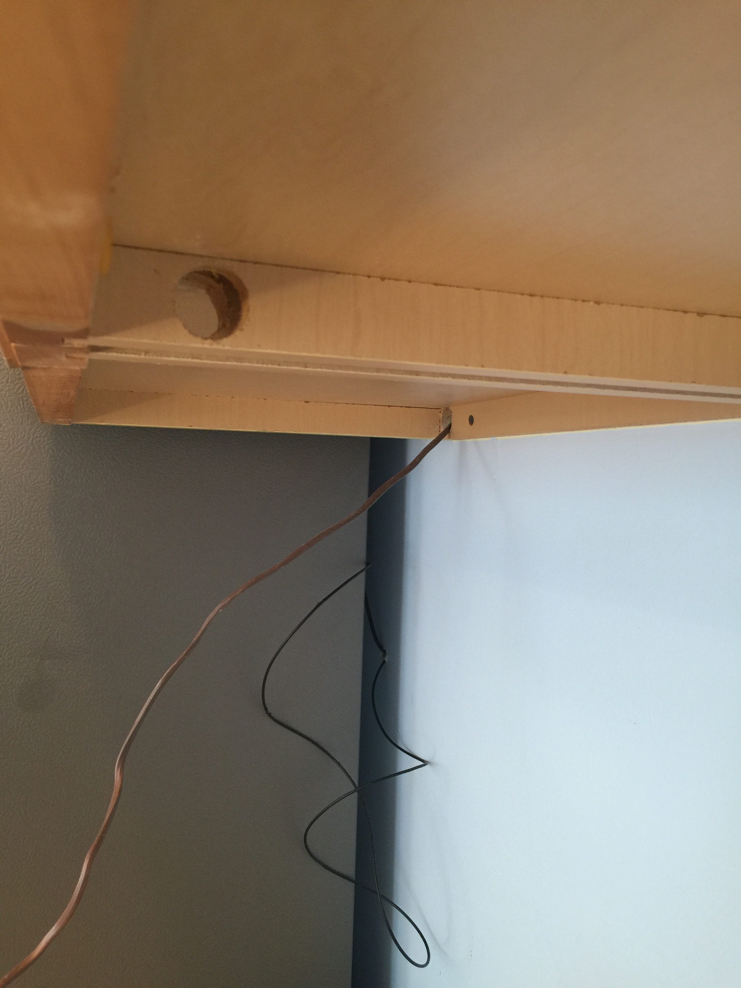

I used thermostat wire and connectors for my LED strips. Put the Controller on a Smart Switch.
