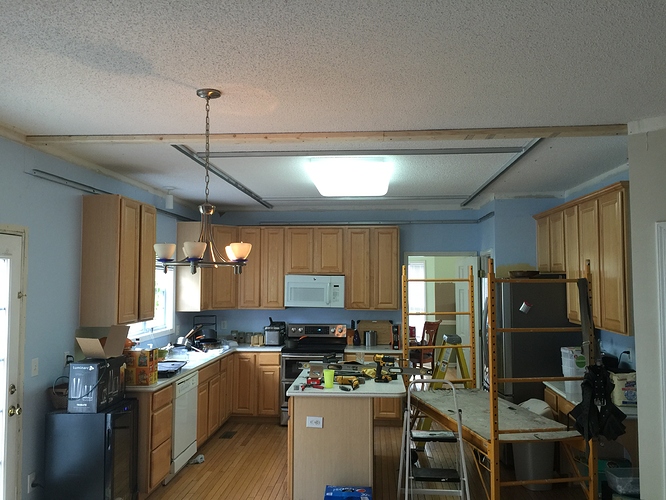

Here’s a “sorta” before:
What brand light strip did you use? I’m thinking from all the reading that many people didnt use the Phillips light strip.

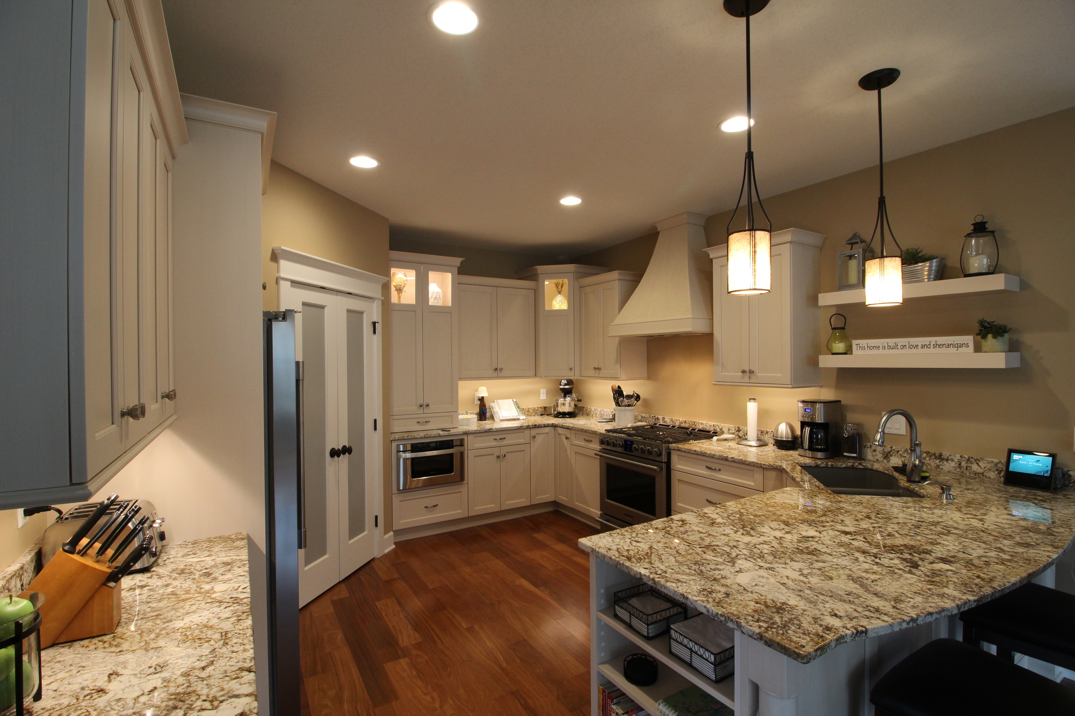

To add to the excellent advice and beautiful examples of kitchen lighting so far in this thread, here’s mine:
There are three smart switches (all on the right side of the kitchen) at work here:
  1. Added the most recently, the (4) ceiling flush-mounted lights are controlled via a 3-way Zooz Zen21 Z-Wave Plus Switch v3/Dumb 3-way ON/OFF switch combination. The nice thing about the Zooz switch is that it can be used with a dumb 3-way (or 4 or 5 way) switch(es). An add-on switch isn’t needed and wiring is easier. The bulbs are dumb LED’s.
  2. The (2) pendant lights (dumb LED’s) are controlled by a 2-way Jasco/GE 14294 ON/OFF Z-Wave Plus switch.
  3. The under-cabinet LED strip lights and (2) in-cabinet (behind the door glass) LED strip lights are controlled by another 2-way Jasco/GE 14294 ON/OFF Z-Wave Plus switch. The in-cabinet and under-cabinet lights used to be wired separately to a single pole top/bottom combination switch. When I changed to the smart switch, I wired them together since having the in-cabinet and under-cabinet lights work together was what I wanted anyway.
Control is via SmartThings, webCoRe, ActionTiles and Alexa. For Alexa, in addition to the individually named switches and associated lights, we have overlapping named lighting groups:
The Lights or Kitchen Lights - Since there is an Echo Show in the kitchen that’s associated with just the pendants and cabinet lights, saying, “Alexa, turn the lights on” while in the kitchen turns on just those lights. Saying, “Alexa, turn on the Kitchen Lights” also works in the kitchen or with any of the (9) other echo devices throughout the house to turn on pendant and cabinet lights.
Cooking Lights - When we cook, we like it to be bright. So, saying, "Alexa, turn on the Cooking Lights turns on the pendant and cabinet lights - and it adds the ceiling lights too.
Having a well-lit kitchen with the flexibility you need/want makes a big difference. Good luck!

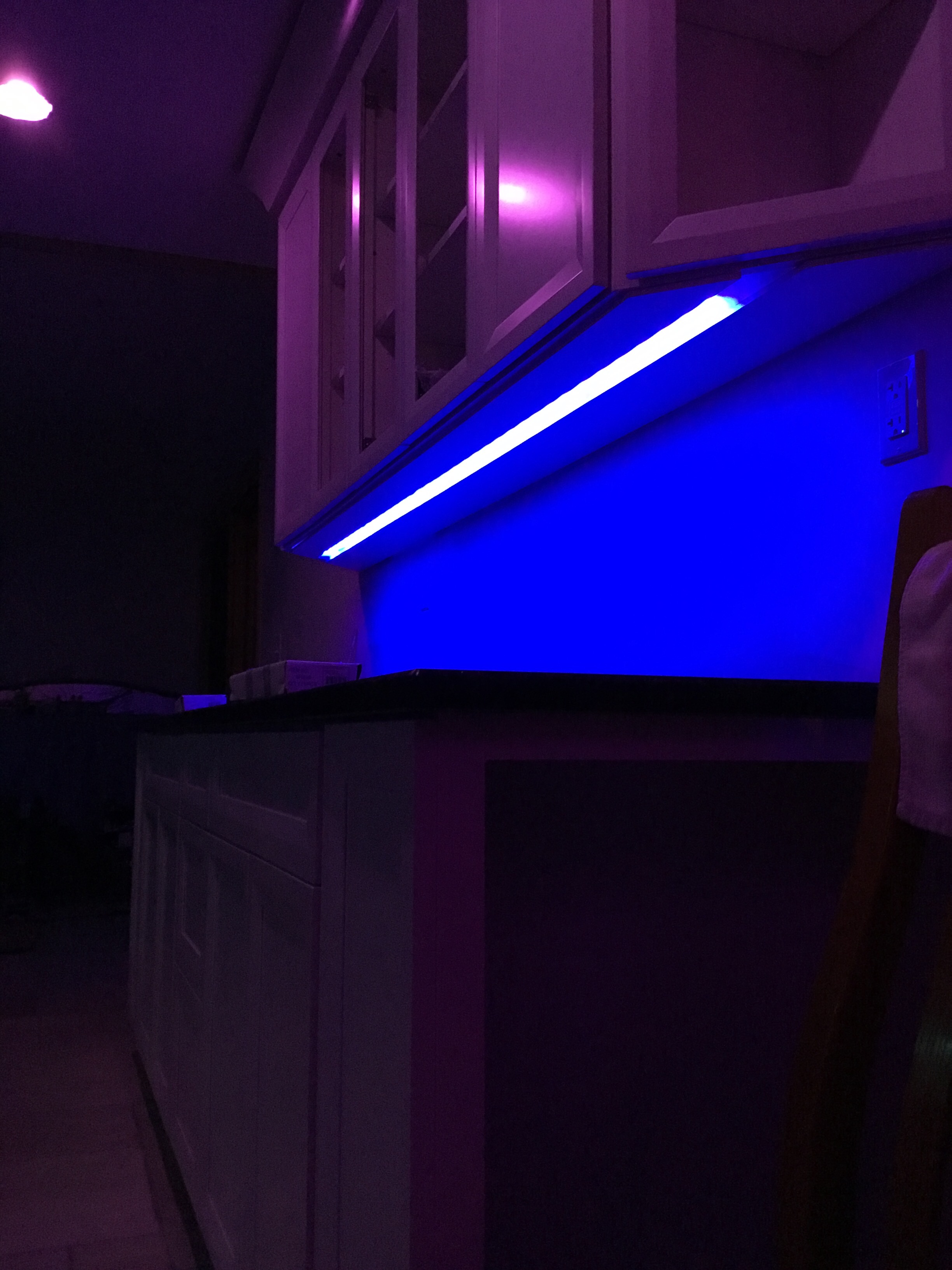

This is a video of my kitchen LED strips using the seller’s controller.
They are now Alexa controlled using “strips dimmer”, “brighter” etc.
