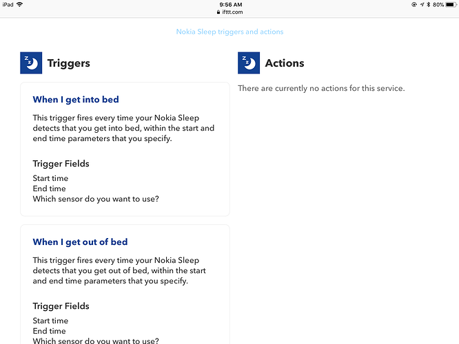

I received my Nokia Sleeps on Friday. As a data nerd, they’re pretty cool. From a smart home perspective, they leave a bit to be desired. Personally, I don’t (or didn’t, rather) have anything using ifttt. As of right now, that’s my only option for this device. So far, IFTTT only has 2 triggers for the Nokia Sleep – When I get into bed & When I get out of bed.
I’m hoping someone smarter than me comes along and integrates them a little tighter with SmartThings. I’d like for the system to turn off my TV after Nokia Sleep determines I’ve fallen asleep etc.
