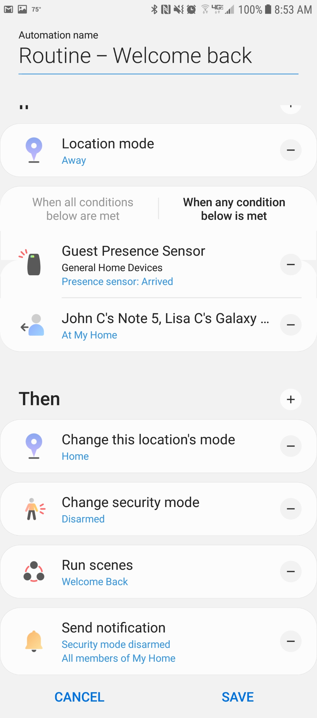

Has anyone figured out presence with FIRST IN ONLY automation? Right now my statement says IF “1” Returns OR “2” returns OR “3” returns THEN “Back”. Using both L360 and ST NewApp presence sensors atm but both operate the same for this issue (repeats with everyone coming home).
It makes sense that “back” is running every time someone comes back, but I only want it to operate when the FIRST person is back.
Yup, but experiment to make sure. I have an automation for this that uses Location mode with the advanced options for Precondition enabled. For some people, I’ve read posts where precondition isn’t being honored, but it’s working for us. I also have individual automations for each mobile presence (phone) that uses preconditions for Location mode, and those work too.
