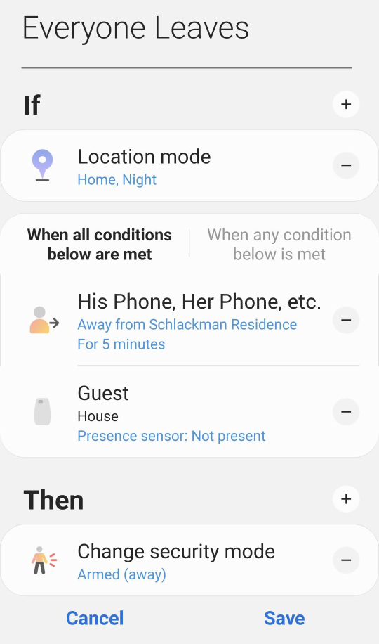

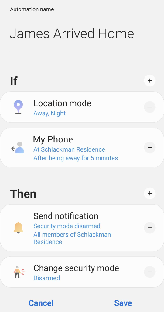

OK, here’s how I got mine working the way I want them. I am 100% convinced now that creating a rule using a location mode precondition along with ‘when any condition below is met’ for presence is simply bugged, so to work around it I’ve split the rules up a bunch. This initially seemed counter to the elegance that the more complex rules should be able to provide, but the upshot is they are easier to debug and most importantly they actually work.
The first thing I did was remove Location mode changes from the arrival/departure automations and coupled them directly to security mode via three short automations as shown below. I found this was also important since I want the location mode to change even if I arm/disarm manually using the home screen STHM controls (which I was doing a bunch when the rules were screwing up and my alarm kept getting set off). Now none of my other automations change the location mode: they only change the security mode and location follows it automatically. This approach may not work for everyone’s setup, especially if you have additional location modes, but it works for me.
Now the Everyone Leaves automation is fairly straightforward and is working for me as follows (actual phone names redacted):
The key to getting arrival working (any single person arriving will disarm the alarm), was to split each person/presence sensor into their own rule per the example below so that each automation only contains a condition based on a single presence sensor/phone.
(+2 more like this with my wife’s phone and our guest sensor).
While this does turn what were originally two automations into a total of 7 for me (with three presence sensors) it does work consistently and as expected now. Splitting the arrival automations up also has the added advantage that the push notifications actually name whose arrival turned off the alarm, instead of just saying ‘Someone arrived’.
