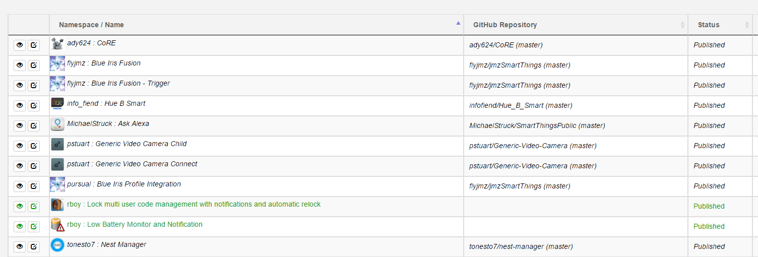

Do you have these areas in your SmartThings App IDE?
Then follow the instructions in the Core Wiki to publish.

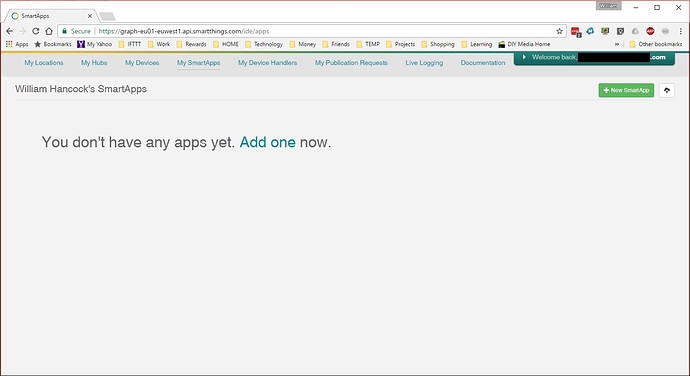

No, in my ST IDE https://graph-eu01-euwest1.api.smartthings.com/ide/apps I don’t have anything except “You don’t have any apps yet. Add one now.”
Hold up… there seems to be a 2nd Location in my ST IDE
I’ve deleted it and managed to get past step 1 & 2 in the instructions.

On the CoRE WiKi there’s a link for the US IDE and another for the UK IDE
If I click on the US Users link https://graph.api.smartthings.com/ I can see the SmartApp in there.
If I click the UK Users link https://graph-eu01-euwest1.api.smartthings.com/ Ther’es nothing there.
Is this all because the SmartApp has been installed in the US IDE Console but my mobile is currently in the UK, where I live?
