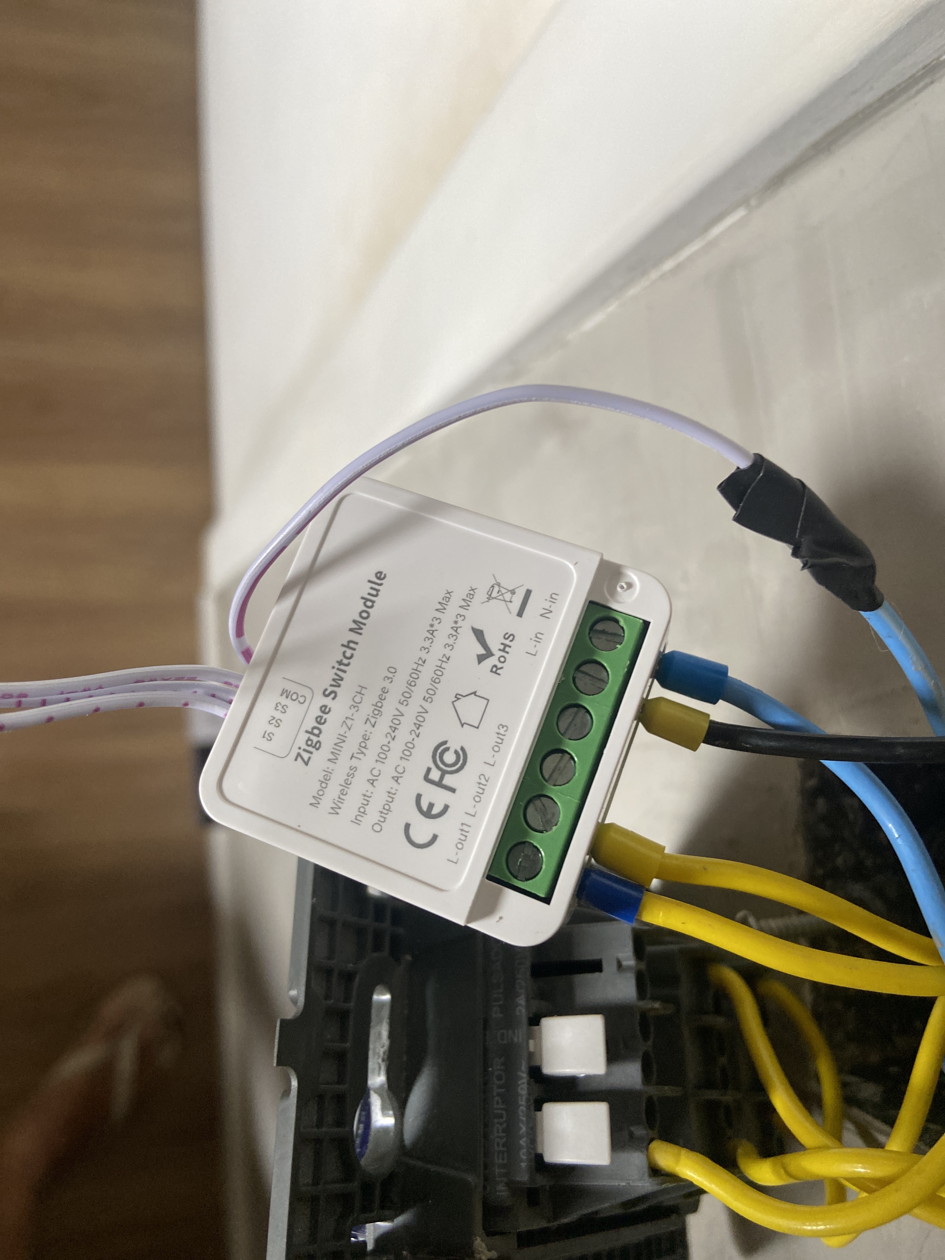

Hi @Mariano_Colmenarejo .
Can you Add the fingerprint at your driver Zigbee multi switch?
Thanks
Hi @Saulo_Vianna
In the capture posted, the manufacturer data is incomplete since the text font on your phone is very large.
That is ok?
Hi,
Added to this driver version
You need uninstall device, install new driver version in your hub and pair device again to device configure
 Name         Zigbee Multi Switch and Child Mc
 Version      2023-12-14T11:35:23.651843682
- id: "TS0003/_TZ3000_lvhy15ix"
    deviceLabel: TS0003 Switch
    manufacturer: _TZ3000_lvhy15ix
    model: TS0003
    deviceProfileName: three-switch
