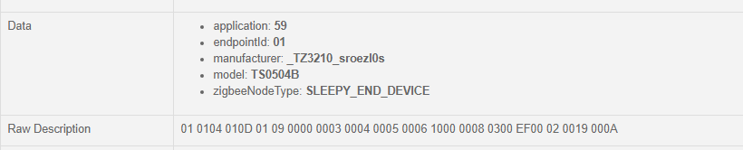

Hi @Mariano_Colmenarejo
Another one i canβt seem to find in your zigbee-light-multifunction-v6
Maybe you will add this
It has the Product Number 14153806L and is identified as Tuya TS0504B, with Zigbee Vendor _TZ3210_sroezl0s
