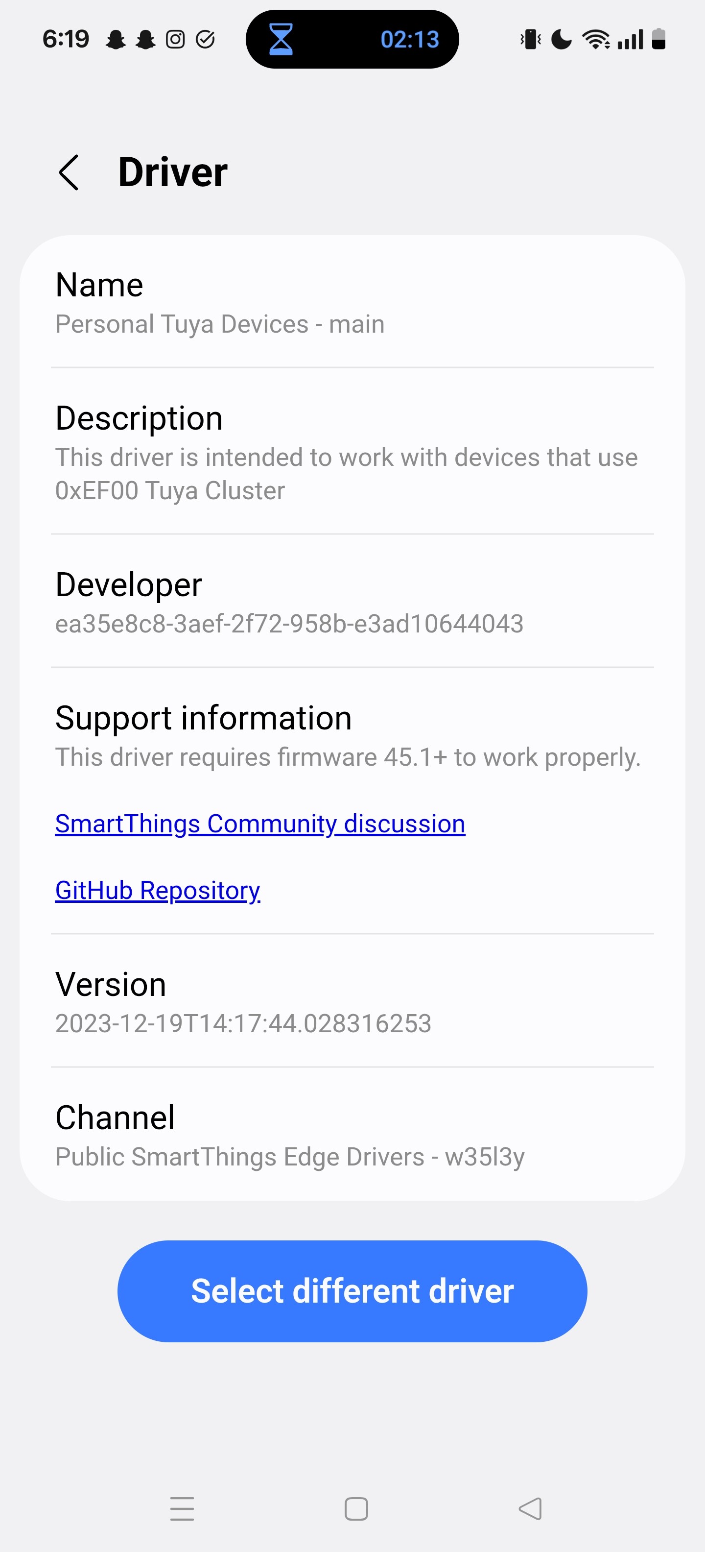

I bought a couple zigbee soil moisture sensors from Aliexpress and I’m having trouble getting them to work. I found some drivers from a SmartThings thread that seemed to have worked for other soil sensors from AliExpress. From my understanding, once I have the driver’s if I disconnect and reconnect to the sensor it should grab the correct driver, but that doesn’t seem to be happening. I have also tried manually selecting drivers with different settings and can’t seem to get it orkings
Below are the drivers I have added

Post your request for help in the following thread with your cluster info and ask the developer @w35l3y for help.
use wesleys driver (personal tuya devices- main)
set it as a temp and humidity sensor.
go to setting and put it as normal for profile.
manufacturer select tze200_yjjdcq… i found if this isnt selected, then the temp decimal is off and everything will be in the 100s.
dp for humidity is 3
dp for temp is 5
dp for batt is 15
then it should update after a while. i got 4 of these things and theyve been working ok.
