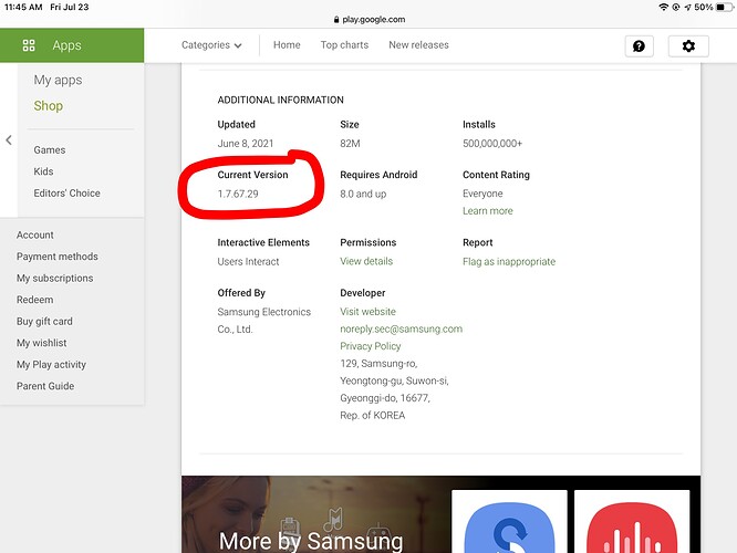

Version level of the SmartThings app.
1.7.67.29 even that took a while to find.

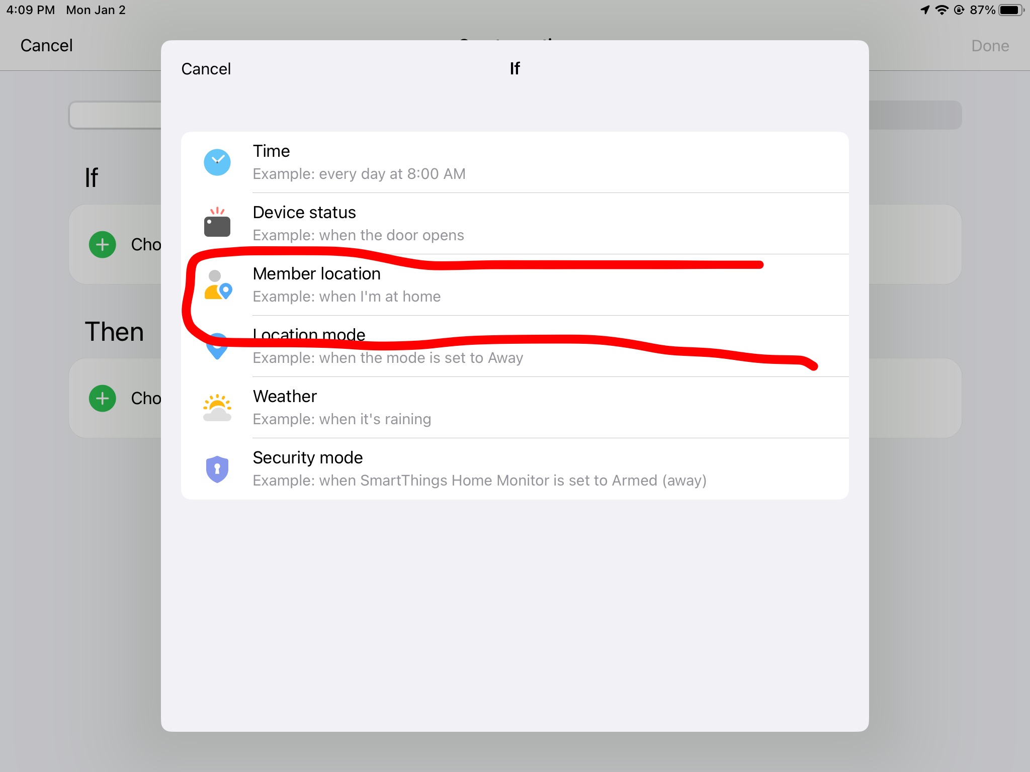

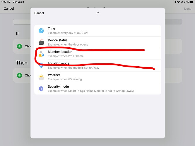

I can’t get the routine to trigger.
This is the routine: If Member location (my iPhone) Any phone or tablet at My home, Then Turn on Office light.
It doesn’t work. I even changed it to Any phone or tablet away from My home and put the phone in the microwave (Faraday Cage) to simulate away. It didn’t work.
I also powered the phone off. It didn’t turn on the light.
I don’t think mobile presence works.
How do I see or test the status of mobile presence. I don’t see any history logs.
I’ve gone into menu setting and toggled the "Get your location from this phone My home. Still doesn’t see the phone.
Those aren’t really useful tests. The app uses the Location’s centre point and radius that you defined to request the phone’s operating system create a circular geofence. Then the phone will tell the app when you enter and leave the geofence using its location services (GPS etc). The app uses that to update your present/not present status in the SmartThings cloud.
So you need to actually go somewhere with your phone switched on and its location and data services enabled, and it seems those services seem to have to be working reliably when you cross the geofence as there doesn’t seem to be any sanity checking going on at other times.
I guess that lack of sanity checking might be reasonable as automations could be relying on timely events. What makes sense happening automatically when you are 150m from your home might not make sense even ten minutes later.
