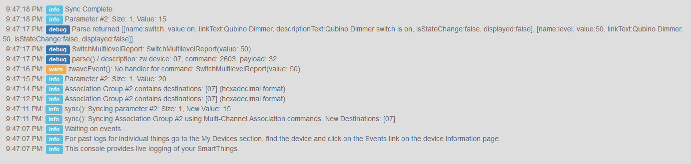

Here is my Live Logging screen when setting parameter 2 with Z-wave Tweaker.
warn zwaveEvent(): No handler for command: SwitchMultilevelReport(value: 50)
