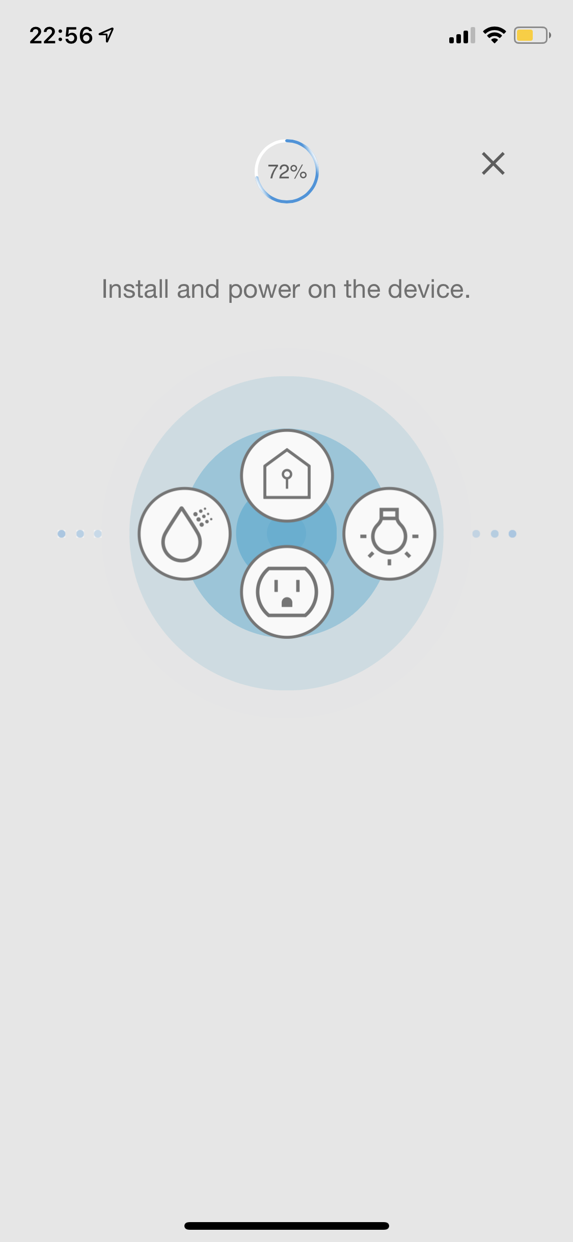

Sorry to bump an old thread but I’m looking for some help with this. I just picked up a 5 button remote and can’t seem to get either classic or new app to see it. I’ve tried holding down the pairing button for 10 seconds, I’ve tried pressing the button 4 times so the red light flashes while the apps are searching, I’ve tried the 4 click reset/battery out & back/4 clicks again but the apps constantly report they can’t see the button.

hey, thanks for the reply. I finally managed to get it to pair after about a hour of trying. I used the new app and just kept trying the 4-button press and then it suddenly saw it on about the 20th attempt. Once it paired I can see all the buttons and map automations to them. It gets really flaky if you create an automation then try and edit it with a different action - it just kept throwing a NETWORK ERROR message, but it seems if you totally delete the action and create a new one. Execution after a button press is a tiny bit sluggish, and doesn’t always work the first time, but overall it’s pretty good!

I’m struggling to pair my 5 button remote with smartthings. i’ve tried both apps but neither work. is there a step by step guide at all to the process. so far i’ve gone into the new app, clicked add, ikea, driver and then held the button down while it searches on the app… but to no avail!!

HI, thanks for that, just tried it again and its found the button, i’m in the UK. when i try to set any routines up thou the app just crashes now. it’s late here thou so will have another play in the morning.
