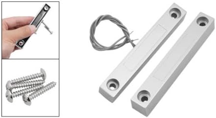

I used a gate magnetic contact switch and a Aeotec dry contact sensor. The switch has a wire on it so, i ran the wire to a remote location to protect it from the weather and abuse. The dry contact sensor is in a weatherproof box, I was able to have it closer to my house for so that I would not have range issues. It works great.
Sonline Surface Mounted Wired Metal Iron Gate Magnetic Contact Switch Alarm
Aeotec by Aeon Labs Z-Wave Plus Dry Contact Sensor Gen5 ZW097-A

If you need something that will operate in much colder temperatures, pretty much your only option is to use a conventional weatherproofed mag closure and run wires to a Z wave radio device which is in a more sheltered location. That’s what people have been describing up above such as in post 13. This should work fine, it’s just a little more work to set up and may not be quite as convenient.
