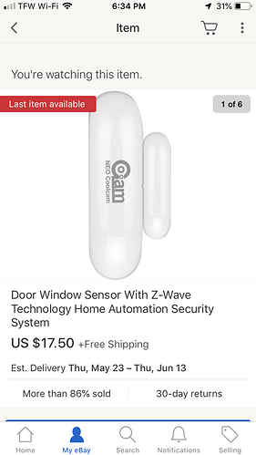

I have been looking for the same thing for a long time. Decided to go the “cowboy way” and bought this thing
sealed it with industrial aluminum tape and stuck it to my mailbox lid. So far so good. My logic behind this is that I will not cry my eyes out when something so cheap fails. We’ll see.
The sensor itself is clunky but very fast in reporting.

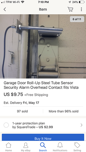

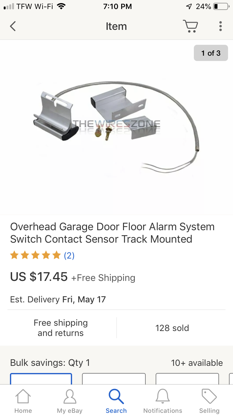

I purchased a garage door open/closed reed switch for a wired alarm system from eBay for $12.17 free shipping. (No longer available, but here are a couple).

But any kind of outdoor cable would work. I was worried about squirrels chewing on the cable is the reason I armored it.
I ran the cable through the same hole in the wall of the house used for my air conditioner and placed the modified open/close sensor inside the house.
The garage door switch mounts on one side of the gate and the magnet mounts on the other side. I used existing screw holes in the gate to mount the switch. The magnet had to be shimmed out a little but wasn’t difficult to find something to mount it. Home Depot sells some flat metal that is about 3ft long with holes above every inch in the plumbing department. Cost about $3.
Cut to length and screwed the magnet to it.
So for less than $40 I have a working gate monitor.
