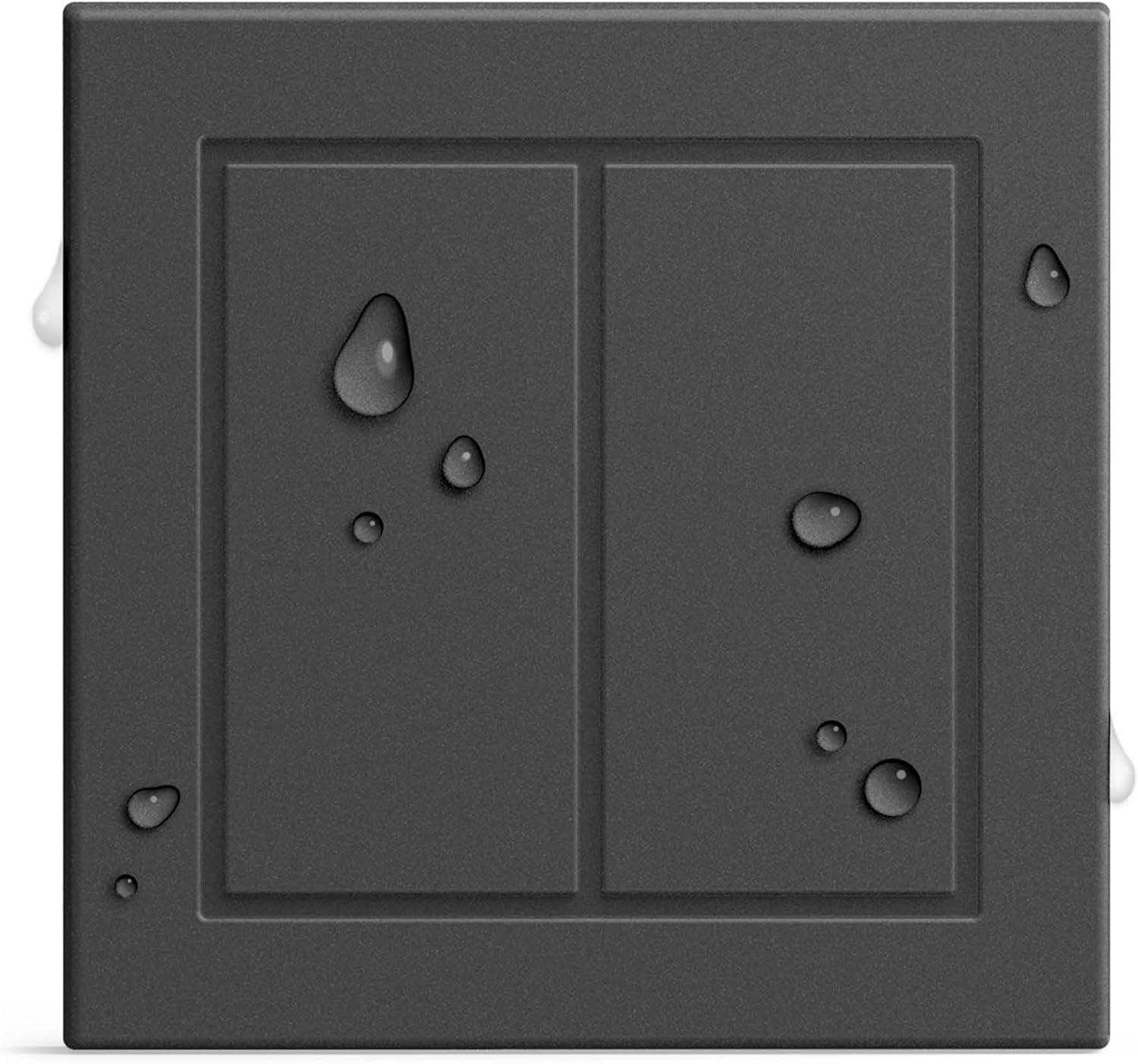

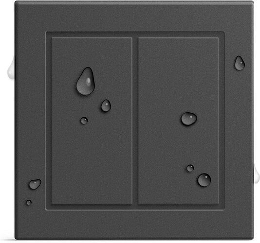

personally, I really like the Gira+Senic double rocker in their friends of hue line. Comes in black, IP44, batteryfree. Typically costs about $80, but that’s for a double rocker and you’ll never have to buy batteries for it.
However, this is a Zigbee Green Power device, so it’s not directly compatible with a SmartThings/Aeotec hub; you have to bring it in through a hue bridge. But I really like mine. If you already have a hue bridge in your setup, I would definitely consider these.
If you use matter, then it’s very easy to add via the Hue hub matter integration.

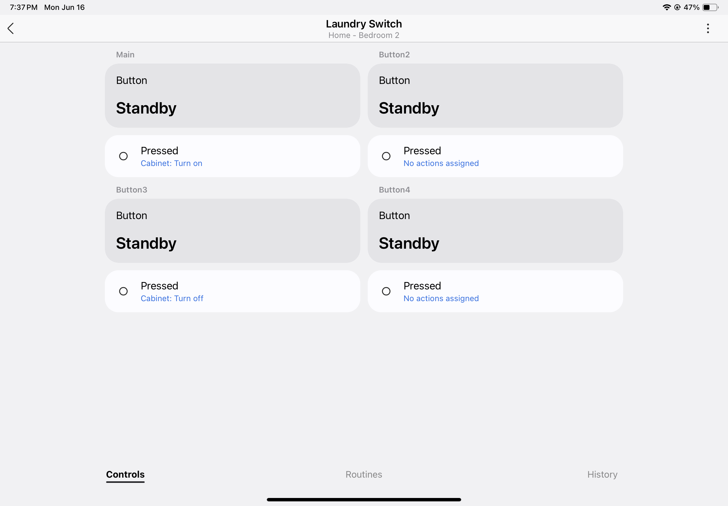

It will look like four separate buttons in smartthings, and you can use them in routines.
