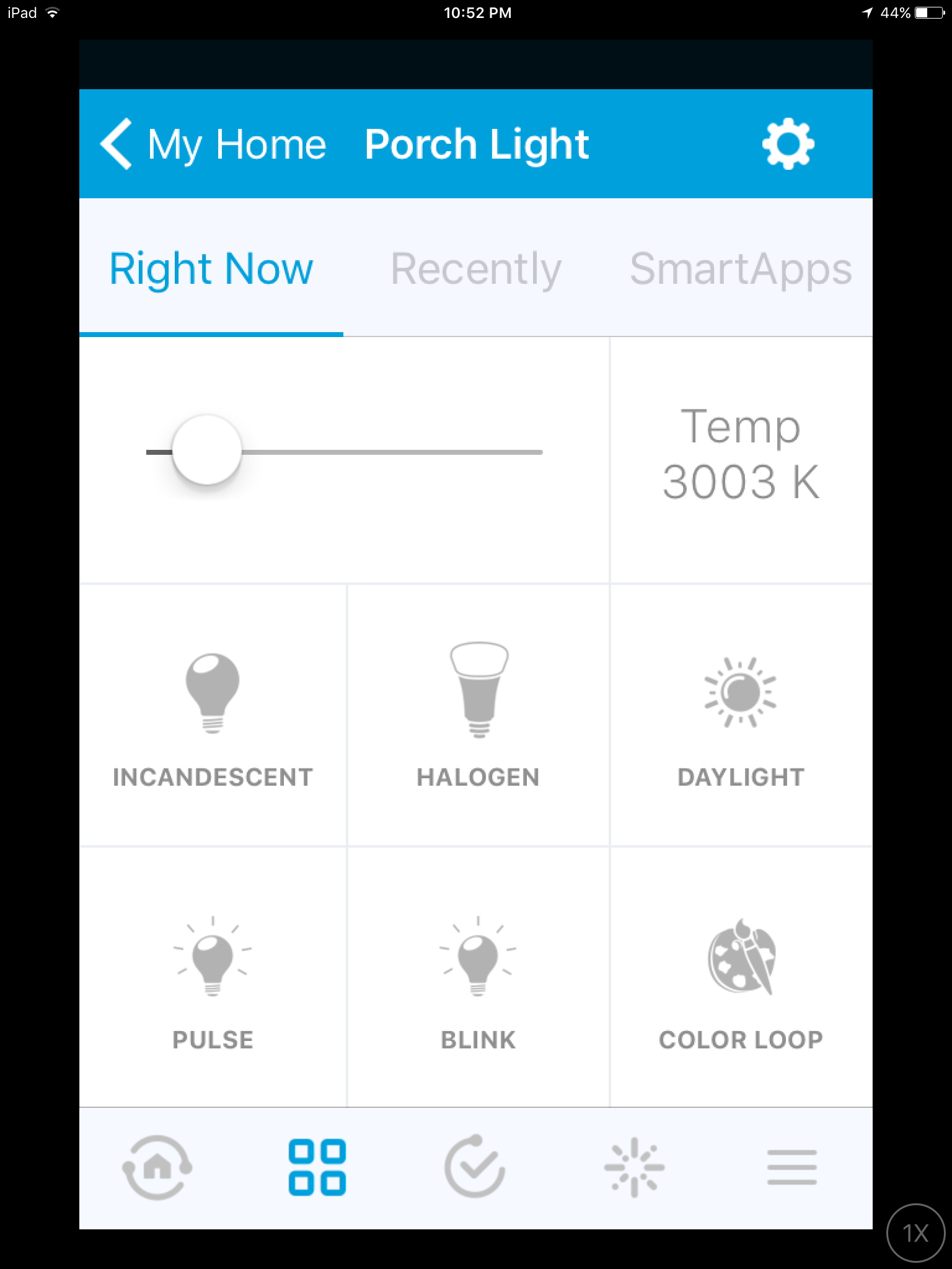

PS. What’s the lowest color temperature these bulbs support? I saw it listed as both 1900 and 2700. I think I saw 1900 on the Lightify app at some point, but the lowest I see it in ST is 2700 (even with this new DTH).
I believe 2700 is the lowest…the A19’s packaging indicate as such
Yup, I see that - strange that the Amazon and Lowe’s listings have it as 1900K.
I’ll pair a bulb to the Osram Gateway tomorrow and see if it goes down to 1900 …
