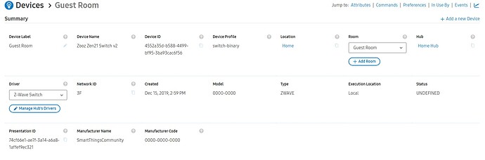

I have 16 Zooz switches and all work fine except one. A Zooz Zen21 Switch v2 won’t give me the option to pick the Zooz driver. The only option is the Z-Wave Switch. Any ideas?
Go to Samsung account. Go to the device in question. Send your “manufacture code” or a screen shot. Its in the form of xxxx-yyyy-zzzz.
That may be the issue. Manufacturing code is listed as “0000-0000-0000”. Other Zooz devices have a code populated.
All zeroes means the device(s) failed to pair properly with the hub. This can happen if a device supports S2 security and the QR code is not scanned or the DSK is not manually entered during setup. Exclude the device, factory reset it, and try re-pairing.
Here is a topic that talks about other reasons as well.
That worked.
