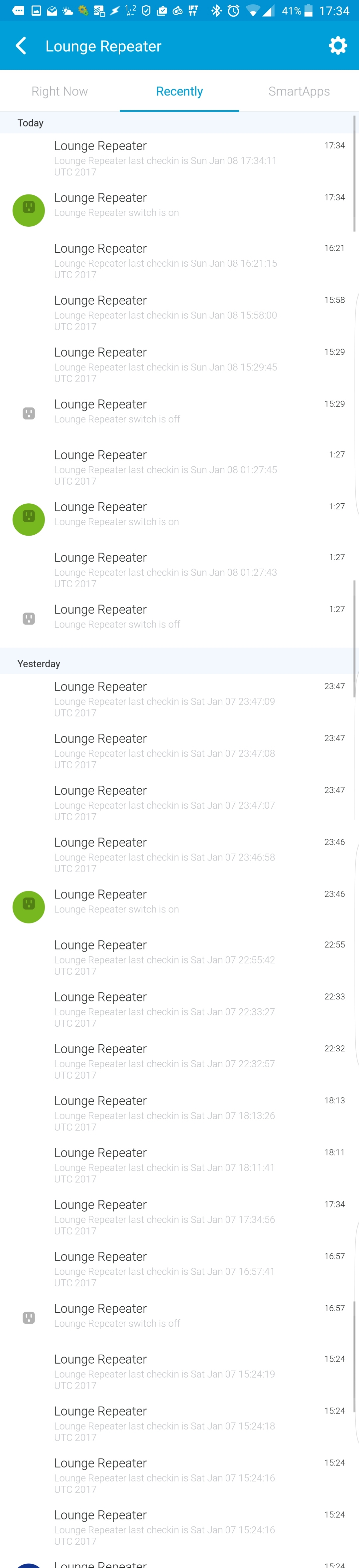

Very curious finding related to this device on smartthings. I’ve paired up 5 of these two days ago and all of them function perfectly well responding to commands to switch on or off. Since I’m only interested in using them to increase my mesh I’ve noticed that 3 of them stop working as relays after about an hour after pairing. Another 2 seem to work fine.
Looking into further, by modding the device handler I can see the working two are constantly sending messages every 10-15minutes to the hub whilst the other 3 only send messages when a command is sent to them.
Working fine:
One working fine but not repeating well:
This could be very similar to the sensors not pairing properly and dropping. However, the difference here is that the outlets continue to function as relays so will not be obvious something is not working.
