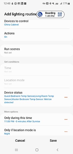

How about simple automation:
If Light is On for X minutes
Than Turn it Off
It doesn’t matter how the light is turned on, after X minutes goes off.
And of course if you need to turn that ligt On, when motion is detected, create another automation for that.

Simple automation to do that.
Screenshot_20211001-185739|250x500
Does this is also trigger if there never was any motion, or does it look only for the “no motion” event?
I do want to avoid this light being left on, but if so this would be much simpler.
My light is generally activated by motion, so motion may be needed.
My Automation that i have posted earlier, turns light off regardless of how is turned on, after X time that you specify.
This one turns Light on when motion is detected.
@Paul_Oliver automation turns light off, X minutes after motion stops.

You can have this with just another automation
Anyway try a couple of this and see which one works best for you. You might need 2 or 3 automations.
