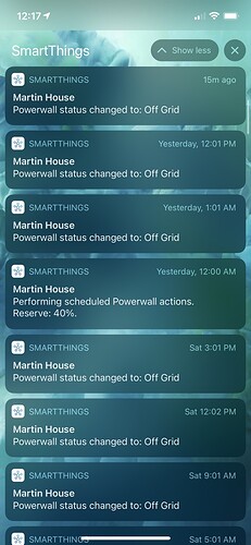

Anyone else having false Off Grid notifications/actions? I am seeing these notifications daily and seemingly random times. I don’t see anything in the normal history in the app that corresponds with these notifications.
I did receive a couple of false notifications a few months ago. Looking at the code, this could happen if unexpected or null data is received. I can put in a check for that.
I think that is likely (at least for me). I see data received around the time it happens in the normal activity log but I haven’t taken it any further by looking at live logging. I do usually check the Tesla app when I get the notification and have not seen any problems there (or in the backup history there). If there is some check you can add, they would be very much appreciated. Thanks for all your work on this.
