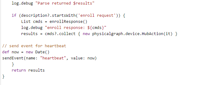

try this,
under:
log.debug “Parse returned $results”
add:
// send event for heartbeat
def now = new Date()
sendEvent(name: “heartbeat”, value: now)
Like this?

I think the other user had to use polling because the battery reporting wasn’t reliable with that DTH, but the device didn’t reliably report back at regular intervals so adding something to the parse method wouldn’t work.
Some of that DTH has been re-written since I last looked at it so it’s possible your recommendation will work now, but I recommend using something like “lastCheckin” instead of “heartbeat” because heartbeat is an actual zigbee attribute that has a different purpose. I also recommend declaring the attribute that is used.
That code needs to go between the "log.debug “parse returned…” line and the “If (description…” line.
This?
Yes that’s the correct location.
I’m not sure if this is necessary, but if you want to be able to open the device from the IDE and see that value, add the following line in between "capability “tamper” and "command “configure” near the top of the page.
attribute "lastCheckin"
I’m still not sure if those changes will work, but it’s worth a shot.
