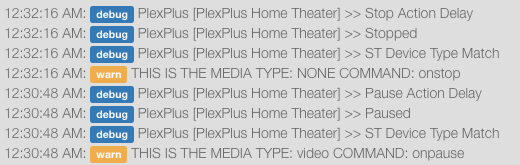

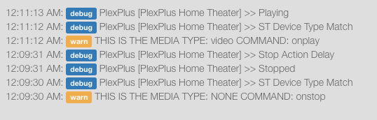

@Entityxenon Not sure if it was a Plex Media Server update that changed something but trailers are now turning off the lights completely as when a movie is being played. The pic below shows Lights On for Stopped status then 2 mins later Trailer 1 begins followed by Trailer 2, then the Cinema Trailer pre-roll followed by the movie start. Statuses were not changing between, trailer, pre-roll, and movie. As soon as Trailer 1 started playing the lights turned off. The top screenshot shows the pause during the film and then the stop.
Hope you can help.
Hi @johnesc ,
Just sat in the airport on my way back home so can’t check properly, looking at the logs though Plex is not passing the required information, I assume you are using webhooks and not the exe? If it is webhooks then there is very little I can do, I know the webhooks passed from Plex are far from perfect… I think the exe method is better in terms of the information available to work with…
