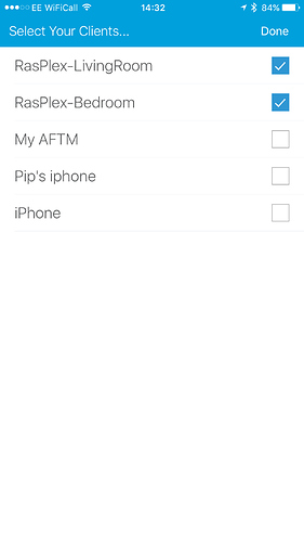

  • Added: New option in SmartApp for selecting specific clients. We will only install devices for those which you select. Items which were previously installed which you unselect will be unsubscribed (so you can manually delete) but we will not delete the device (it may be registered with other SmartApps). If you have used Plex Manager before this update, the client selection page may not have your clients selected, just select them and continue. Thanks @toliver182

  7. Pick the clients you want to add to SmartThings and hit ‘Done’

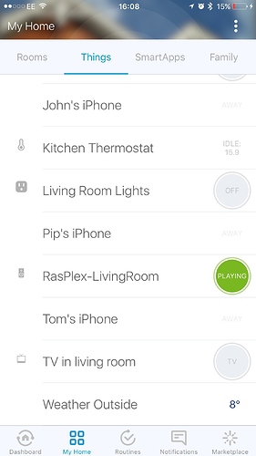

  8. Tap ‘Done’ and go back to ‘Things’, whrere you will see your Plex devices there
