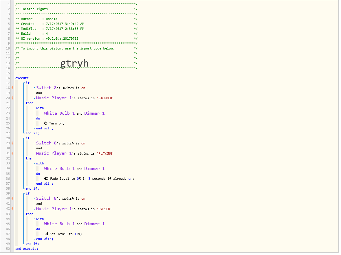

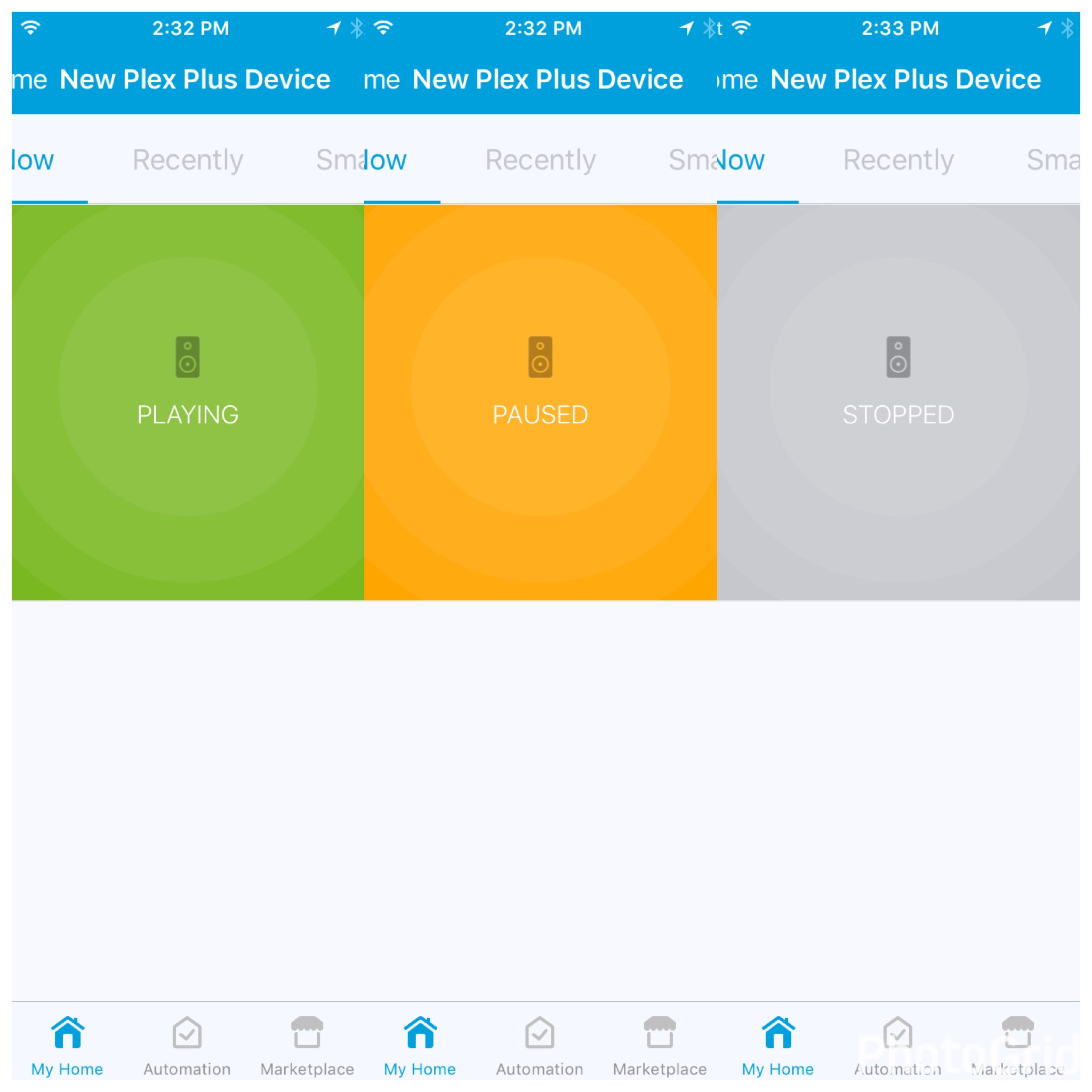

hey I figured out how to eliminate the app from controlling light while keeping update device on. however in webcore when I select the device and say if status is equal to a value no preset choices come into the drop down menu of status values. I had to manually type in stopped, paused, and playing which I got from the app itself
so I assume those are the statuses. after trying to run the piston nothing happens with the lights so I’m thinking the problem maybe how the script is written. should I be selecting something else besides status for the if clause? the choices are (level, mute, status, track data, track description, $status)
here is the piston
Yes it does, I see your issue…
I can set it only to work when the switch is off, I can just add another field, will do in a bit
