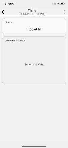

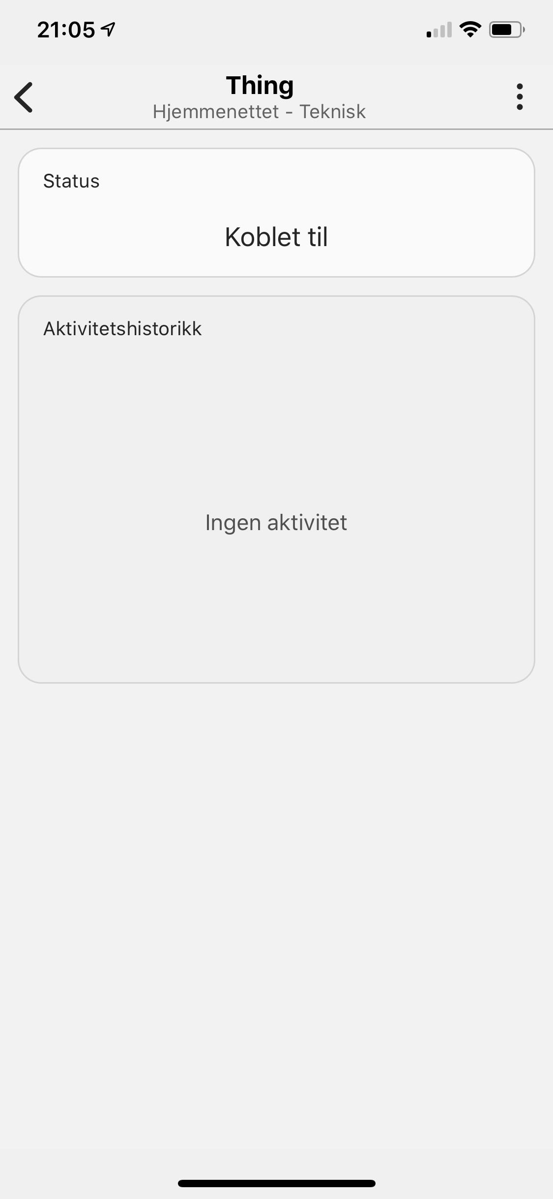

Hi Tore,
I have an almost identical device, a Develco MEIZH-061. I have gone through the documentation for it and changed only a few things. However I am not able to get it to show anything important.
The two tecnical docs here for comparing:
With this code I manage to add the device but only with the classic mobile app, not the new one.
When connected however the “thing” is showing “please wait” in the classic app, and connected but no activity in the new app.
I hope you can point me in the right direction on this one.

I also have to mention that I get nothing in the logs. I also see now that you eare referencing device.rmscurrentpha which is not what it is called in the new device. Could it be that simple?
It should not be “Thing” in your classic app. So you have to change the device handler for your device to the one you have created. This is done under My Devices in Smartthings IDE.
ok, that was stupid of me, but I learn something everyday. I thought the connection between the device handler and the device was automatic, when you had a device handler with the correct device information.
Ok, so what happened now is that there was a small change in the behavior. I got two new tiles, but still no data.
My guess is that this is due to either incorrect naming or some incorrect attribute. I have changed the cluster id to fc00 instead of 0b04 and the attribute ids since this seemed logical according to the two technical documents. This may of course be incorrect. I am feeling that I am so close now.
Do you get anything in Live Logging at all from device? I had to do a factory resetting to make it work first time. But not sure if it was an acctual problem or a user problem…
I had to factory reset it to make it connect to smartthings at all. First of all it connects as a “thing” My guess is that if I factory reset it now it will not reconnect to the same device, but a new “thing”. But I can try.

ok, here are my findings:
Did a factory reset of the device, and it stopped working. Deleted the device and tried to readd it.
Impossibe to do from the new smartthings ios app. Tried again from the old app and it actually found the device with the name I gave it,so not a “thing” anymore.
I had already published the debugging, and by looking at the live logging, something turned up:
