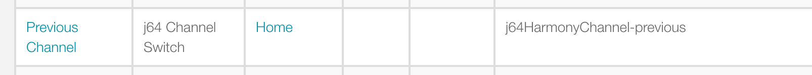

I have everything installed at mac mini and It running well, However, I try the “previous channel” at Web or in SmartThing Apps, Nothing happen, I try mute, volume increase, decrease, Surfing and turn to HBO channel, all well. Do not know why previous channel does not work ?, Could someone try and feedback ? By the way, the timing 750ms is too short to allow Harmony input the channel number, 800ms is very good…

I will have to add some extra debugging info onto the screen so we can see why it is not sending that previous channel command. The app expects a a command called “previous” on the device but that must not be how it is defined in your hamony hub device. I will add some code to make that easier to figure out and will let you know when it is out there.
If you are a programmer and want to have some fun debugging the code, there is a SendCommand method in the Hub.cs file. It will search all of the devices for your channel device. If you set a breakpoint there and look through that device structure there is a command that should be called “previous”. I just noticed that one of my devices calls it “ChannelPrev” so that would cause a problem if i had selected that as my Channel device in the j64 app.
If you do discover the correct command name you can manually fix the smart things device by going into the smart things IDE and changing the device id to match. So in this case I would have to set it to “j64HarmonyChannel-ChannelPrev”.
You can also easily try different command names via the j64 API by using this url: http://localhost:2065/SetChannel/PrevChannel The last part of that URL is the command name you are sending so you can always just experiment with it until you find the right name.

@joe64 I check the command at LogicTech Harmony Forum, and most of article do mention the command is “ChannelPrev”, However, I try to modify the Device ID in SmartThing IDE to “j64HarmonyChannel-ChannelPrev”. But It seem after I change and update the Device in IDE, and I run again at SmartThings and WebAPI, all still useless, Do not know where is still got wrong…?
I just checked in a change to github that could help to track down the issue. If you want to get the latest copy of the source code and restart the app, it will now write a file called myHubConfig.json into the wwwroot directory. That will show us all of the devices and how the different commands are named. Be sure to change back the network id on that device in the IDE. Also this should not overlay the local configuration of device names but it does not hurt to save off all of the *.json files in that wwwroot directory first.
