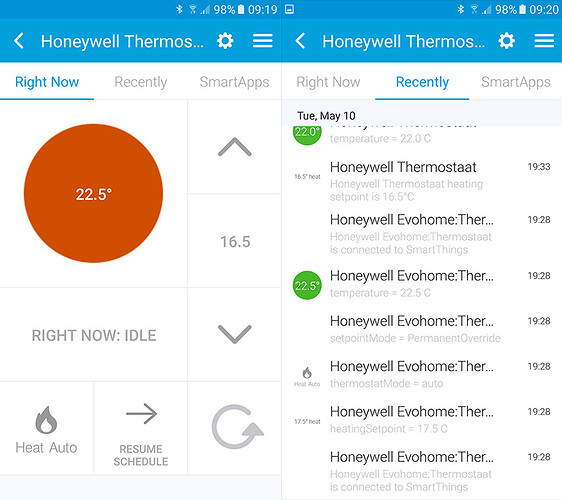

But this is how the thing looks with my Single Zone thermostat:
Doesn’t look like it based on the previous post! Still pretty useless then I’m guessing.
